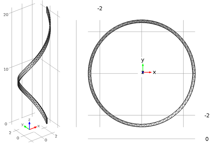

Art,
Attached is helix with a major radius of 2.5mm.
“Quite coarse resolution” is just visualization effect – see mesh image where geometry is resolved quite well.
Sergei
Art, Attached is helix with a major radius of 2.5mm. “Quite coarse resolution” is just visualization effect – see mesh image where geometry is resolved quite well. Regards, Sergei
Posted: 1 decade ago 12.03.2013, 17:41 MEZ
Sergei,
Thanks for your response and the file, that's exactly what I needed. Question though: through trial and error, I figured out how to get a helix of 20mm length by tweaking the z expression (s*6.5) of the parametric curve.
I got what I wanted ( or close) but don't understand this relationship. Is there a better way to make the helix length variable in a way that will show a relationship for the length?

Atr,
Attached is helix with parametrized dimension of pitch length of 20mm.
Sergei
