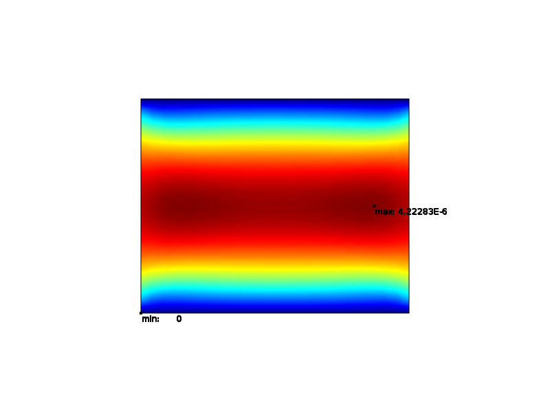

Dear all,
I would like to ask how can I find the flow velocity of a specific point (x=105, y=2.5) in my channel (it is shown in the picture). In the graph, if I click at any random point I got 3 values: on the x axis I got the channel's length, on the y axis the height and the different colours represent the flow velocity profile and hence, I got 3 values for x,y and u.
But I would like to find my velocity at a specific point, so could you pleqse help me how can I do that?
Thank you a lot beforehand.
Regards
Dimitrios

to define a fixed point, ifits not define as the intersection of two-three bundaries ,thne you can use the Data Set Point interpolaton option (Results - Data Set right click) and then point the "point" plot to that derived data set. the velocityfiled in solid is (ut, vt, wt), while in CFD its simply (u,v,w)
Hi to define a fixed point, ifits not define as the intersection of two-three bundaries ,thne you can use the Data Set Point interpolaton option (Results - Data Set right click) and then point the "point" plot to that derived data set. the velocityfiled in solid is (ut, vt, wt), while in CFD its simply (u,v,w) -- Good luck Ivar
