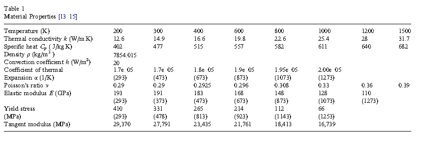

i have analysed thermal stress by passing the laser beam on rectangular plate (through structural mechanics module).i used stainless steel temp dependent material properties to my simulation. i used elasto plastic properties yield and tangent modulus. i have attached the properties also.i satisfied with results of deformation of plate and temperature profile. but my major problem is von mises stress exceed the ultimate stress level.
how can i reduce the stress value??

Thanks for your reply.i used temperature dependent properties by using interpolation function.but i am getting 700mpa von mises stress .but stainless steel ultimate tensile strength is 515 mpa.

The ultimate tensile strength of the material is not accounted for in the elastic-plastic material model you are using. Therefore if the strains are high enough you can get stresses around 700 MPa. That would require a very large temperature increase though and an overly constrained structure. What temperature increase are you applying? Check also that you are using an elastic-plastic material and not just elastic.
