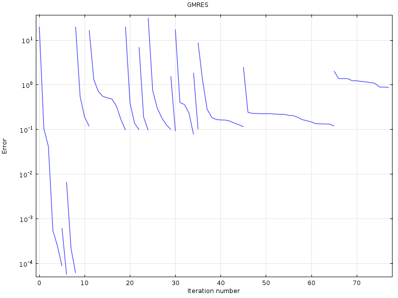

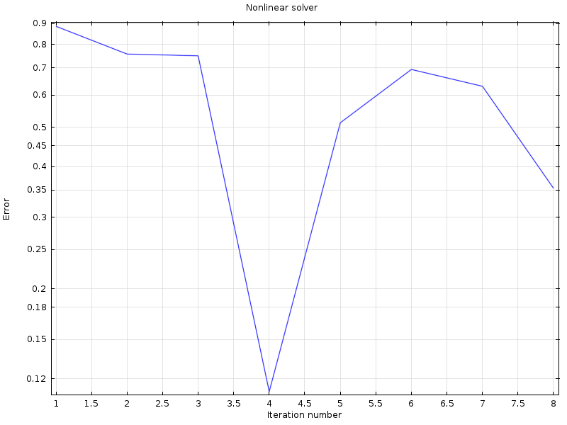

I am not having any results so far. I have uploaded the convergence plots for both step 1: laminar flow, step 2: TDS and my model. At the beginning I wanted to define a lateral (zx in this case) boundary as symmetric boundary for then mirror it. The latter was unsuccessful and I defined it as a wall without results. I have used the default iterative solver and direct solver, I have change the mesh from coarser to fine, I also changed the multigrid mesh coarsening factor from 2 to 1.5 and increase the relative tolerance, all of them at the same time or each one separatelly without any success.

I have some trouble as you to make spf in 3D converged. I try GMRES with multigrid with Vanka, SOR lines preconditionners with no success. I try spf P1+P1 elements type and a direct solver MUMPS it works but i want to how to compute Navier Stokes (spf P2+P1) with multigrid solver.

thank you for your answer. I did almost the same, I changed the spf to P1+P1 but I left the Iterative solver (GMRES) and it finally converged. My guess is that maybe the turbulence made by the mixer lead to oscillations in the second order elements of velocities. However, I would like to maintain the P2+P1, do you or someone else know if this can be done?
