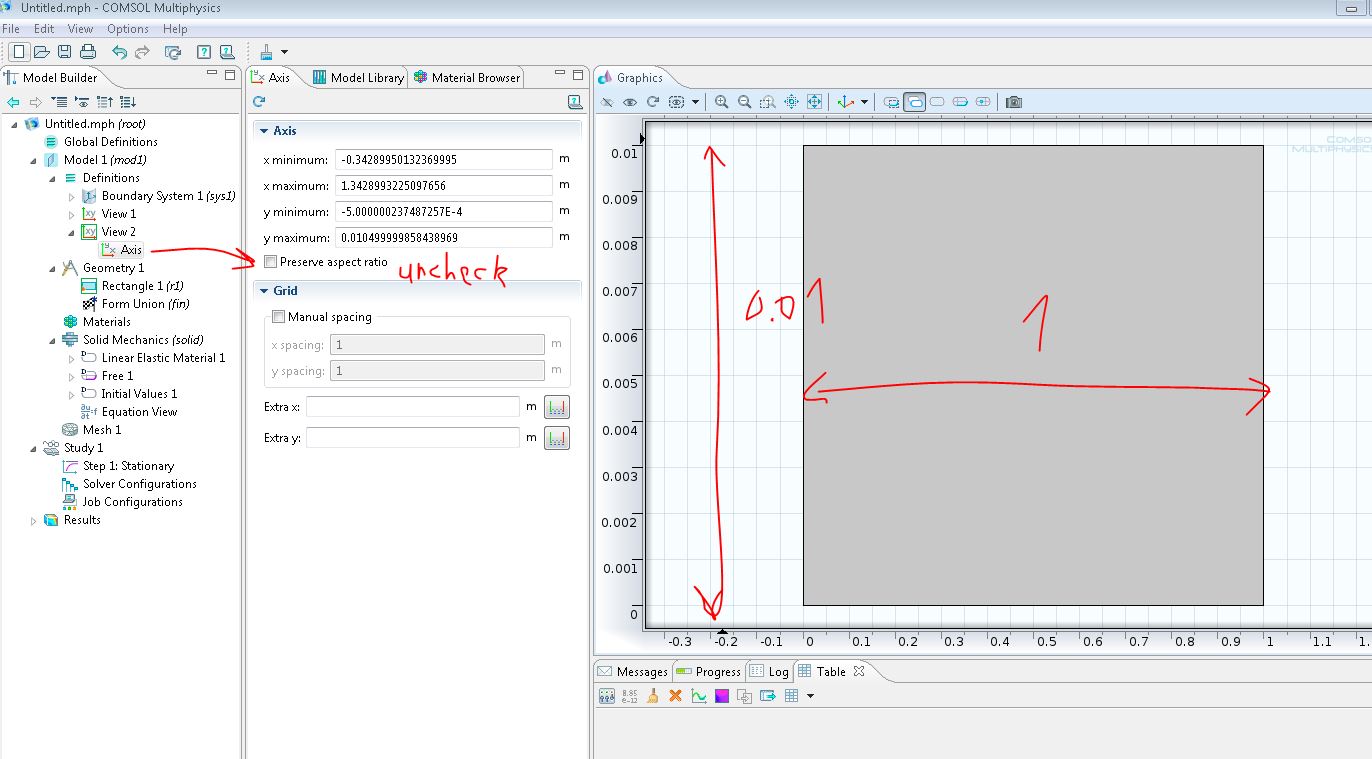

Posted: 1 decade ago 20.03.2013, 20:06 MEZ
take a look, this is for 2D, its almost the same in 3D
Hi take a look, this is for 2D, its almost the same in 3D -- Good luck Ivar
