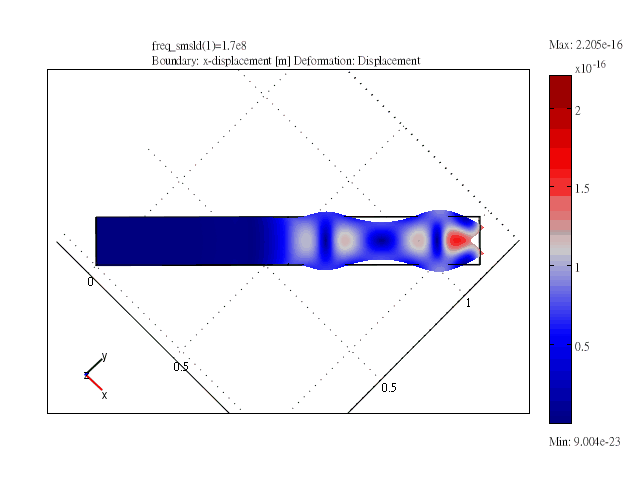

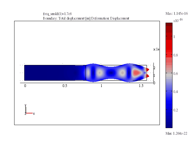

First one, I define the PML(click 'absorb in x direction') to be on the left half of the beam and
solve the frequency response by applying a harmonic force on the right hand side wall.
Result: Enclosed please find the attachment 'deg0.gif'
Second one is an identical model, but its geometry is rotated 45 degrees (click 'absorb in x & y direction').
Result: Enclosed please find the attachment 'deg45.gif'
Why PML doesn't work in the second one?
Is there any PML solution for a rotated model?
