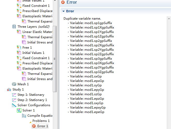

in model library, a model named layered_plate simulated thermal deformation with two mechanics,considering
Liner Elastic and using the result from first mechanics as the intial stress can get a good result , but when considers elastoplastic with two mechanics,it failed with an error: deplicated variables,
i need to consider elastoplastic and use the initial stress same as Layer_plate,what i should do?
otherwise, if after computing some results ,how can i call it correctlly to another study process(the two studys compute seperated )
anything appreciate
thanks
