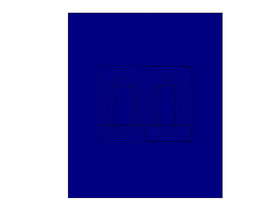

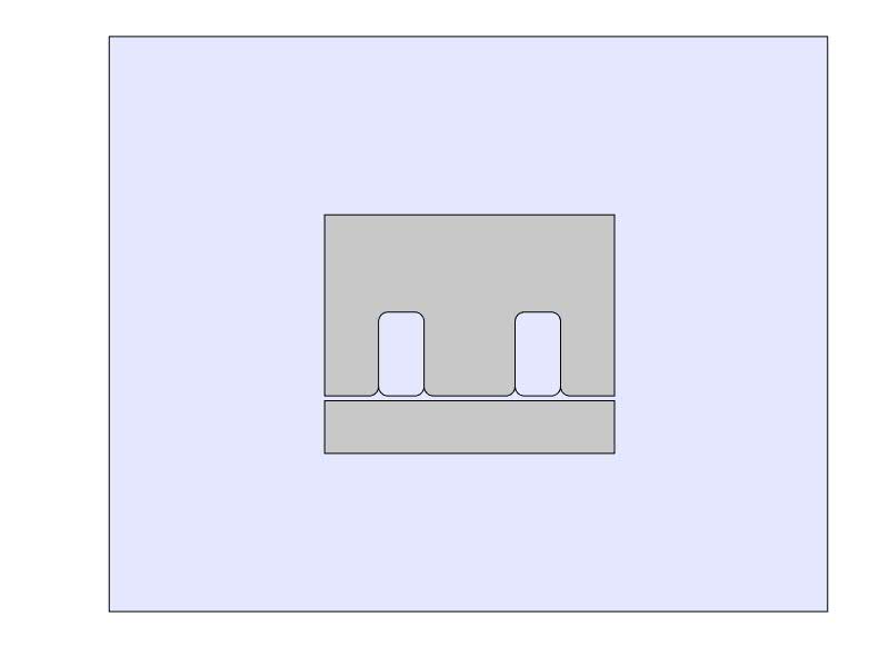

I'm dealing with a very simple problem that has been very frustrating for me! I would appreciate if any one can assist me with that.
I'm modeling an E-shaped core in 2D magnetic field module. It has a flat rectangular armature that is to be attracted by the magnetic force produced by the coil. I attached the schematics.
I've faced some problems and have some questions regarding that.
First, for very small values of air gap which is the distance between the armature and the core, I expect a very large force. However, that's not what I received from my simulations. The force is very small in the beginning. After a threshold, it jumps up to a high value and follows the expected profile afterwards. I believe there is some setting that I need to apply for small air gaps that I'm missing. I attached the force profile.
Second, I need to see the movement of the armature under the effect of an external force detaching it from the core. Can I do it by just adding the structural mechanics module and a body load? Also, how can I model the contact between the core and the armature as they are supposed to be touching each other in the beginning.
Third, how can I read the inductance of my system. I cannot find any option to select after adding .
And finally, I need to connect the coil to an electric circuit. The problem is that this coil is constituted by two rectangles in 2D which are in deed connected on two ends of the actual paradigm. How can I connect such thing to a circuit as an inductor?
I appreciate any help in advance.

force calculations are dependent on the meshing, and also on all sharp corners as here the filed is undefined (what is the derivative at an vertex, in which direction ?
Often by rounding off corners you get better results.
Then when simulating objects that move, be aware NOT to change the topology, leave a small air gap so that the geometrical ID of each entities remains
Anyhow force simulations is based that you surround your force calculation item by all air around it, multiple mu_r domains around the boundaries to integrate will give errors in the force calculations

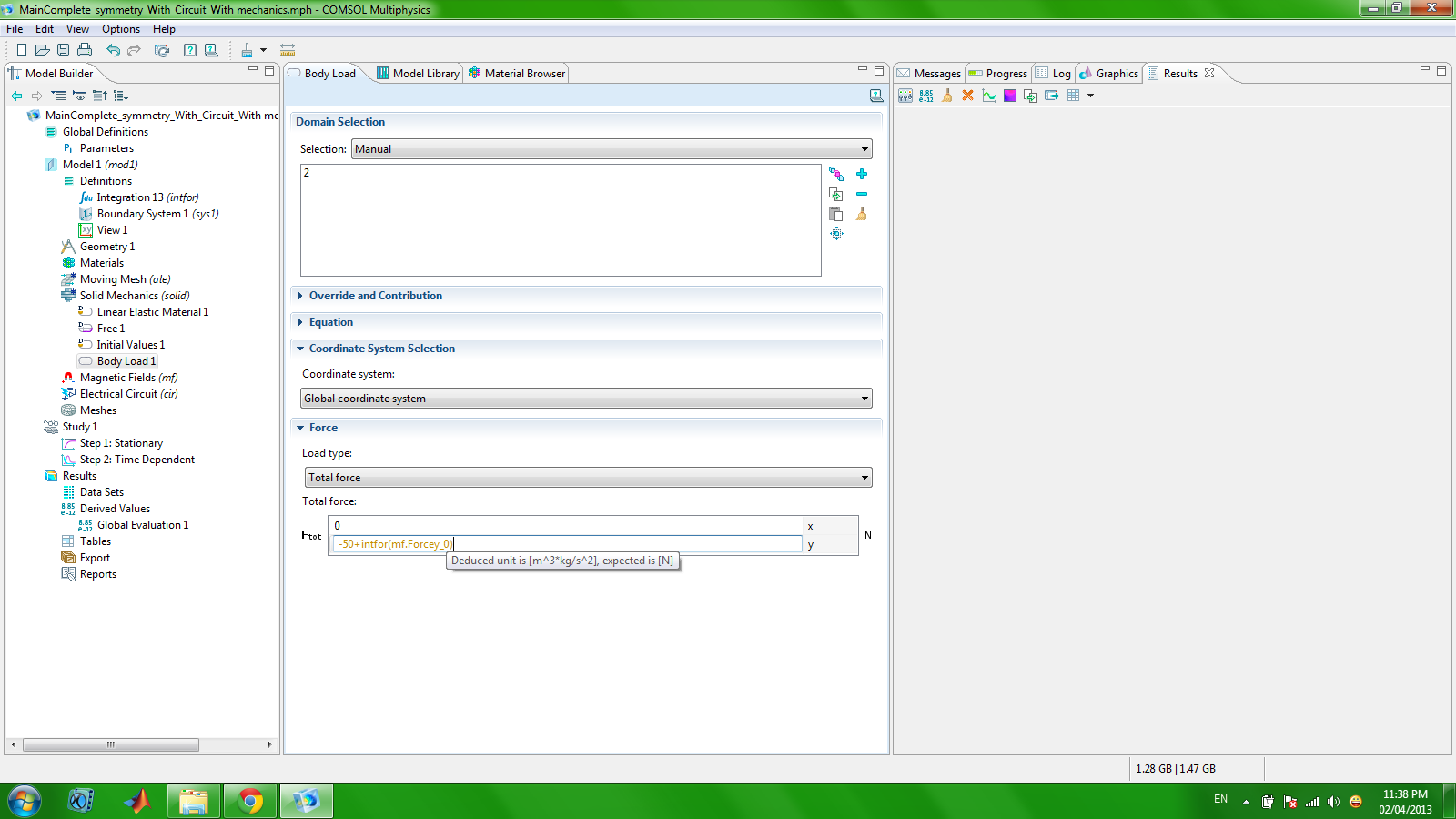

Hello
I'm somehow progressing and getting some results! :)

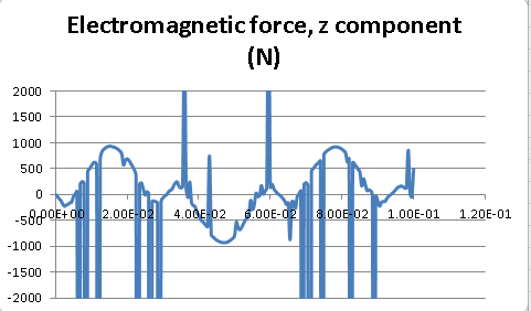

I defined an integration on the armature plate to measure the total magnetic force applied to it. When I want to use this integration in a formula, it shows up in orange text. I know that it does work with it, however, when I hold my mouse on it it tells me that the unit it can deduce from my expression is not Newton. (Please, see attached picture)
I think I'm not wrong about the formula. Do you have any idea what it can be generated from?
Thanks again
Hello I'm somehow progressing and getting some results! :) I defined an integration on the armature plate to measure the total magnetic force applied to it. When I want to use this integration in a formula, it shows up in orange text. I know that it does work with it, however, when I hold my mouse on it it tells me that the unit it can deduce from my expression is not Newton. (Please, see attached picture) I think I'm not wrong about the formula. Do you have any idea what it can be generated from? Thanks again
Posted: 1 decade ago 03.04.2013, 07:51 MESZ
orange is unit warning (not considered as an error but might give wrong resultsif COMSOl does not interprete the values as you expect), your "50" has no units, so write rather 50[N] and then check that the units of your function or integration is ending up in N or you might have N/m and then you need to multiply by the 2D depth (probably 1[m]) to get the orange warning to turn blac (=OK)
Hi orange is unit warning (not considered as an error but might give wrong resultsif COMSOl does not interprete the values as you expect), your "50" has no units, so write rather 50[N] and then check that the units of your function or integration is ending up in N or you might have N/m and then you need to multiply by the 2D depth (probably 1[m]) to get the orange warning to turn blac (=OK) -- Good luck Ivar

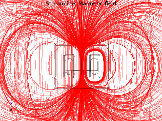

Hello Ivar

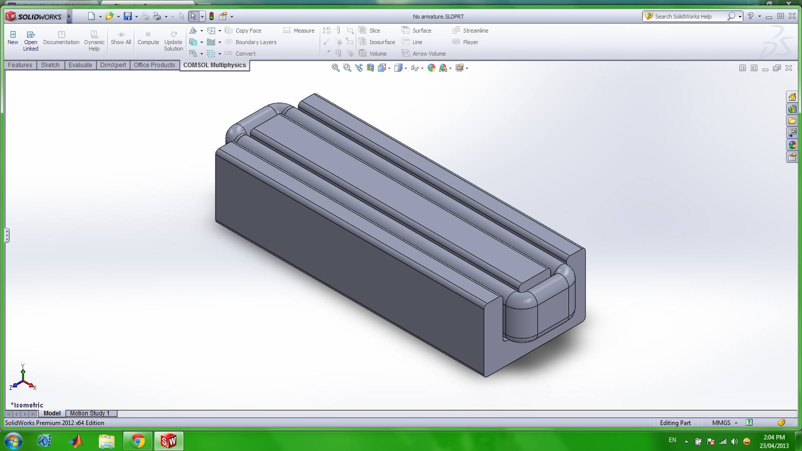

I modeled my system in 3D as well.

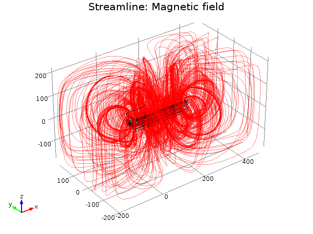

The force that I observe is way less than what I expect! The armature is surrounded fully by air.
Also, when I sketch the streamlines, they don't seem symmetric! The system itself is symmetric. (Please see the attachments)
Any clues?
Thanks
Hello Ivar I modeled my system in 3D as well. The force that I observe is way less than what I expect! The armature is surrounded fully by air. Also, when I sketch the streamlines, they don't seem symmetric! The system itself is symmetric. (Please see the attachments) Any clues? Thanks
Posted: 1 decade ago 04.04.2013, 23:05 MESZ
first of all from that angle it's not clear how they loop around, then you must play with the plot settigs, the source, the densities, how the stream lines are started and distributed
Hi first of all from that angle it's not clear how they loop around, then you must play with the plot settigs, the source, the densities, how the stream lines are started and distributed -- Good luck Ivar

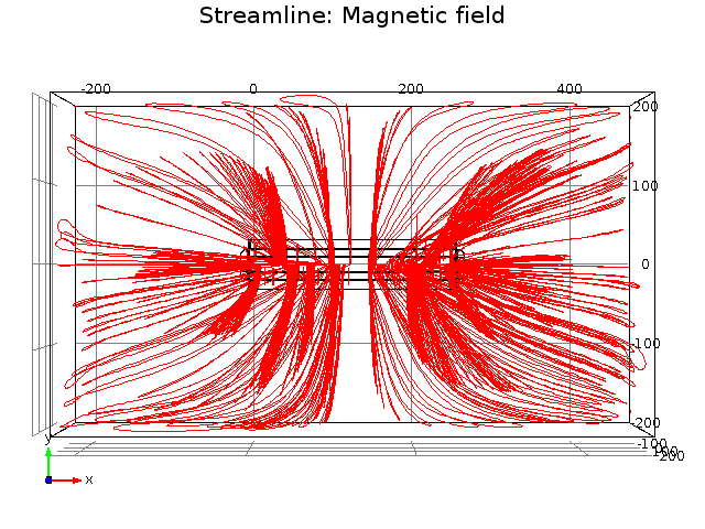

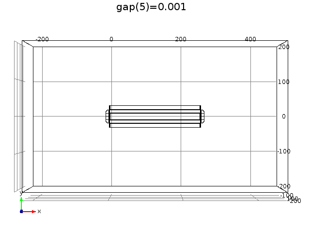

Hello Ivar
Stream lines are Magnitude based and are for the Magnetic flux density!
I attach the 3D view here. I also attach the front view. I don't know why I don't get a symmetric result although the model is symmetric!
Thanks
Hello Ivar Stream lines are Magnitude based and are for the Magnetic flux density! I attach the 3D view here. I also attach the front view. I don't know why I don't get a symmetric result although the model is symmetric! Thanks
Posted: 1 decade ago 04.04.2013, 23:27 MESZ
looks good like that, to perform better line selection you must study the different tabs on the GUI for the streamline plot, you might get also some hints from the videos on themain COMSOL site
Hi looks good like that, to perform better line selection you must study the different tabs on the GUI for the streamline plot, you might get also some hints from the videos on themain COMSOL site -- Good luck Ivar

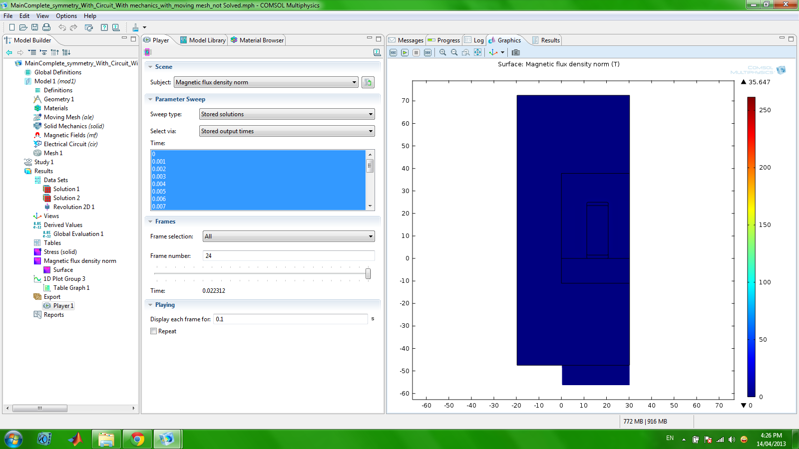

Hello
In the post-processing, when I extract an animation, it does show the magnetic flux; but the movement of my armature is not shown.
In the past, I could get the magnetic and structural mechanics results (Movement of the armature) in the same animation. I cannot remember how I did it! :)
Do you know how I can do this?
Thanks a lot.
Hello In the post-processing, when I extract an animation, it does show the magnetic flux; but the movement of my armature is not shown. In the past, I could get the magnetic and structural mechanics results (Movement of the armature) in the same animation. I cannot remember how I did it! :) Do you know how I can do this? Thanks a lot.
Posted: 1 decade ago 13.04.2013, 01:55 MESZ
I attache the animation I extracted. This may help.
As you can notice, the armature's movement cannot be seen!
I attache the animation I extracted. This may help. As you can notice, the armature's movement cannot be seen!

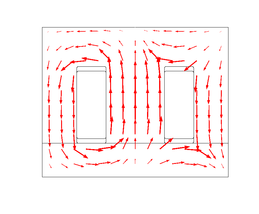

I faced also with this problem when applying mirror to my data sets.
The solution does not seem to be exactly mirrored! Please, take a look at the attached screenshot!
Thanks for the help.
I faced also with this problem when applying mirror to my data sets. The solution does not seem to be exactly mirrored! Please, take a look at the attached screenshot! Thanks for the help.

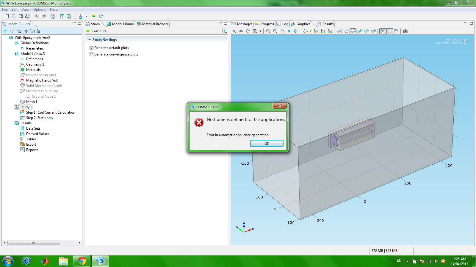

Hello Ivar

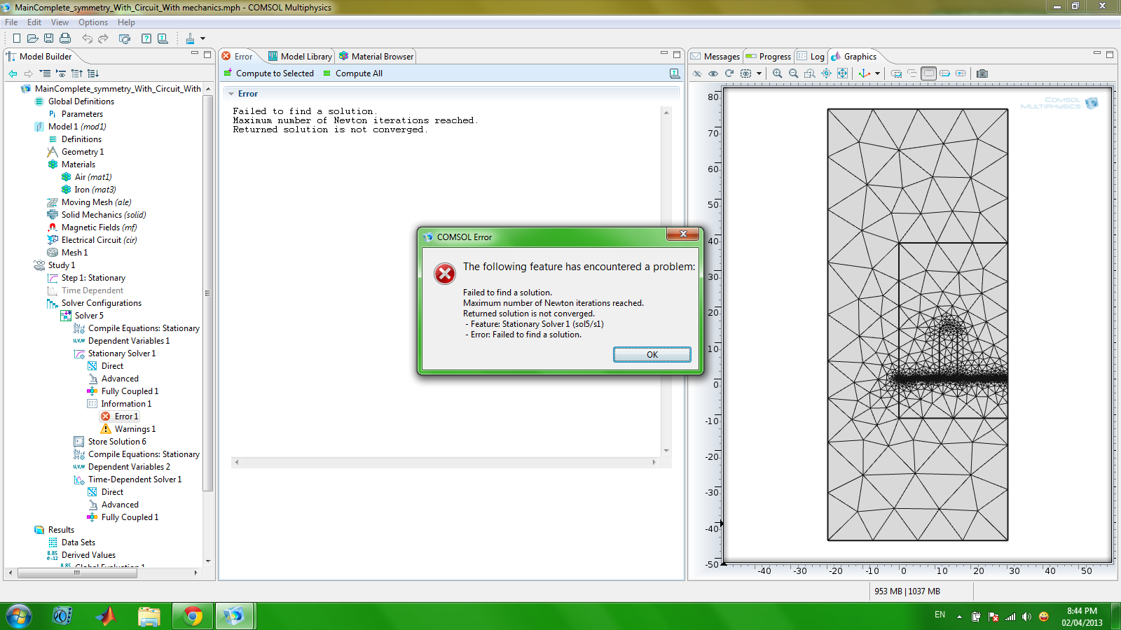

I'm trying to do the 3D modeling now. I noticed that everything is fine until I add the Electric circuit module. Even when I disable it, when I want to access the solver, it shows me an error saying " No frame is defined for 0D application". I am pretty sure it has something to do with the electric circuit module as when I delete it, the problem is resolved!
This is exact same problem in this forum:
www.comsol.com/community/forums/general/thread/34984/
But, there is no solution for it, what so ever!
Do you have any idea where this problem may have arisen from?
Thanks
[QUOTE] Hi The "natural way" is to calcualte the force via a MF force domain node (integration over ity boundaries) and apply that as a boundary load in Solid (normally COMSOL will propose the lonk in the drop down lists -- Good luck Ivar [/QUOTE] Hello Ivar I'm trying to do the 3D modeling now. I noticed that everything is fine until I add the Electric circuit module. Even when I disable it, when I want to access the solver, it shows me an error saying " No frame is defined for 0D application". I am pretty sure it has something to do with the electric circuit module as when I delete it, the problem is resolved! This is exact same problem in this forum: http://www.comsol.com/community/forums/general/thread/34984/ But, there is no solution for it, what so ever! Do you have any idea where this problem may have arisen from? Thanks
Posted: 1 decade ago 14.04.2013, 10:59 MESZ
Indeed I agree the 0D equations are typically the electric circuit ones, probably there is a node linke iisue as you cannot graph your node/net map it's easy to make errors. On the other side, if you have "just a resistance or a source you can model these without the CIR phyiscs too, it's only when yo have a comlex load, or a full feedback circuit loop that I use CIR physics, for that it is very nice, but a AC source term or a simple resistive load can be added as a weak constraint too
Hi Indeed I agree the 0D equations are typically the electric circuit ones, probably there is a node linke iisue as you cannot graph your node/net map it's easy to make errors. On the other side, if you have "just a resistance or a source you can model these without the CIR phyiscs too, it's only when yo have a comlex load, or a full feedback circuit loop that I use CIR physics, for that it is very nice, but a AC source term or a simple resistive load can be added as a weak constraint too -- Good luck Ivar
Posted: 1 decade ago 14.04.2013, 17:55 MESZ
But, my electric circuit is disabled! Why does Comsol care about it?
Hi But, my electric circuit is disabled! Why does Comsol care about it?
Posted: 1 decade ago 14.04.2013, 17:57 MESZ
My circuit is an RL circuit whose L is the coil of my model! Do you have any simpler suggestion?

Hello Ivar
Could you please take a look at the attached picture and see what is happening when I try to run a player! :)
The armature's boundaries do not move; but the body moves! The picture should be clear. you can see the boundaries are attached to the core but the body can be seen at the bottom coming out of the surrounding air! :)
Thanks
Hello Ivar Could you please take a look at the attached picture and see what is happening when I try to run a player! :) The armature's boundaries do not move; but the body moves! The picture should be clear. you can see the boundaries are attached to the core but the body can be seen at the bottom coming out of the surrounding air! :) Thanks
Posted: 1 decade ago 15.04.2013, 06:59 MESZ
sorry but from what you show there I cannot see anything "obvious and wrong" but the details are in the numerous sub nodes, the way the ALE and Solid is linked, the solver continuation / parametric sweep settings and many more
Hi sorry but from what you show there I cannot see anything "obvious and wrong" but the details are in the numerous sub nodes, the way the ALE and Solid is linked, the solver continuation / parametric sweep settings and many more -- Good luck Ivar

Hi Ivar
I just wanted to show how the armature goes out of the air. you can see it at the bottom of the page! I did not link ale with solid specifically! I thought comsol does it automatically! Am I supposed to do anything to link them?
Hi Ivar I just wanted to show how the armature goes out of the air. you can see it at the bottom of the page! I did not link ale with solid specifically! I thought comsol does it automatically! Am I supposed to do anything to link them?
Posted: 1 decade ago 16.04.2013, 11:49 MESZ
but that can be as well postprocessing and graphics, as well as true model dependent (in which case it shows rather that you have missed a BC or some definitions in the ALE)
Hi but that can be as well postprocessing and graphics, as well as true model dependent (in which case it shows rather that you have missed a BC or some definitions in the ALE) -- Good luck Ivar

Also, the magnetic flux density lines look a little awkward except for t=0 and at the end!
Do you know why that happens?
Also, the magnetic flux density lines look a little awkward except for t=0 and at the end! Do you know why that happens?

I did model the system as you said! In solid mechanics, I used prescribed displacement and I could see the movement of the armature and its combination with MF.
Could you tell me how I can modify the current modelling? Do you confirm my Moving mesh?

I attach the 3D view of my system. Armature will place on this part. This shows the core and the coil.
thanks
Hi Thanks. I have a coil; but isn't 2D-axi just for when I have an axis of rotation? I attach the 3D view of my system. Armature will place on this part. This shows the core and the coil. thanks
Posted: 1 decade ago 24.04.2013, 11:29 MESZ
you are right, so you have a looong coil ;)
then 2D is correct but you should simulate a cut in the middle and use either a full "left" & "right" model or apply a correct symmetry /antisymmetry for the curent flow at x=0
Later you might consider 3D, but that demands far more CPU power and particularly time
Hi you are right, so you have a looong coil ;) then 2D is correct but you should simulate a cut in the middle and use either a full "left" & "right" model or apply a correct symmetry /antisymmetry for the curent flow at x=0 Later you might consider 3D, but that demands far more CPU power and particularly time -- Good luck Ivar
