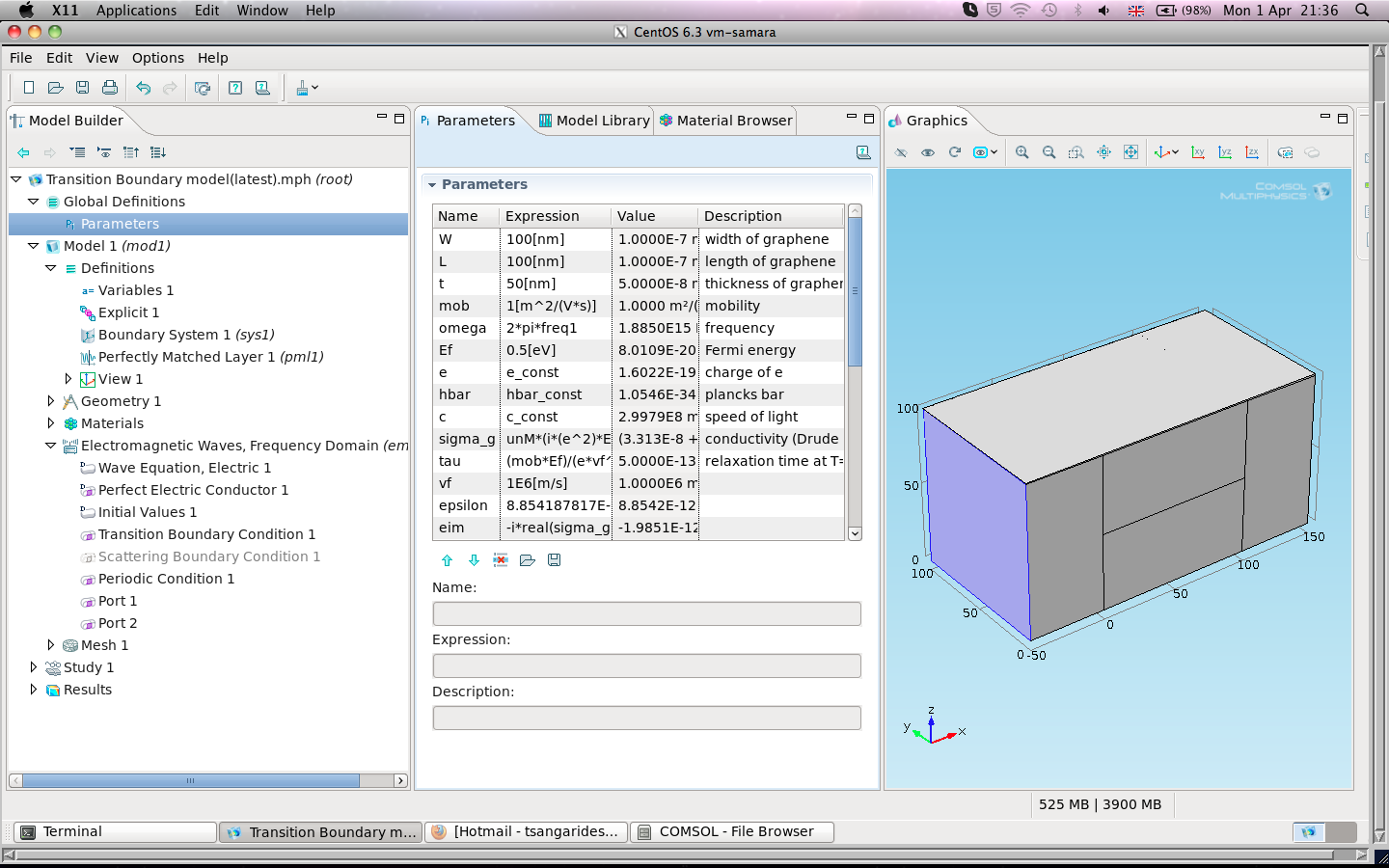

So, in the parameters I have written some equations in order to find out the conductivity (sigma_g)
and relative permittivities (real imaginary/ ereal eim)

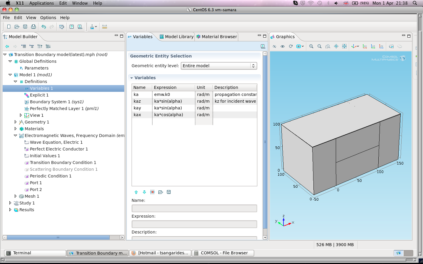

In the Propagation wavevectors I have written the k-vector of light in order to emit it from port 1 in the x direction oscillating either in z or y and having an angle alpha to the z axis.

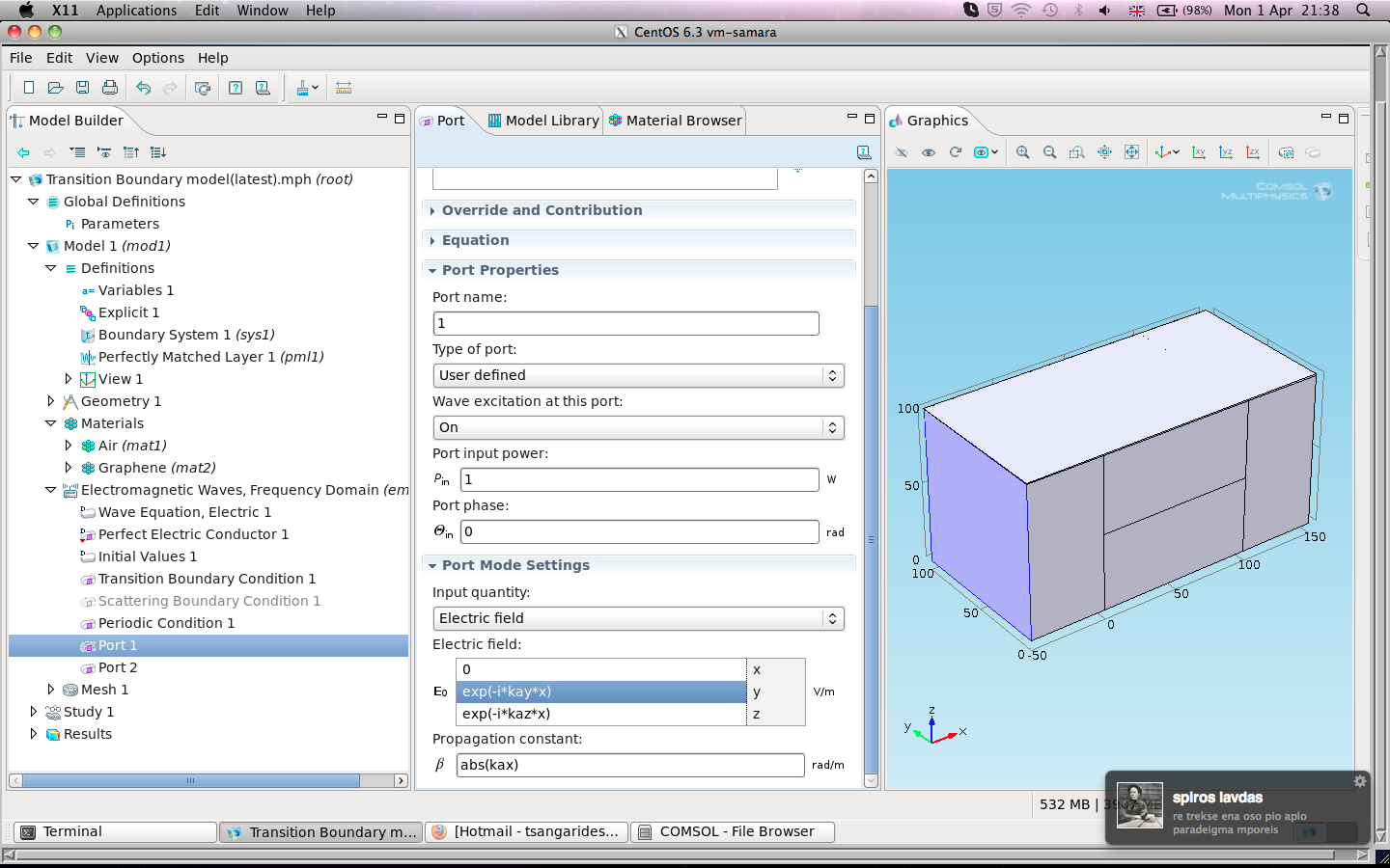

In the Port1 image, there is a trial for how to emit this light but I have no idea what to write in the propagation constant, and also I think I have written wrong the Ex,Ey,Ez fields.

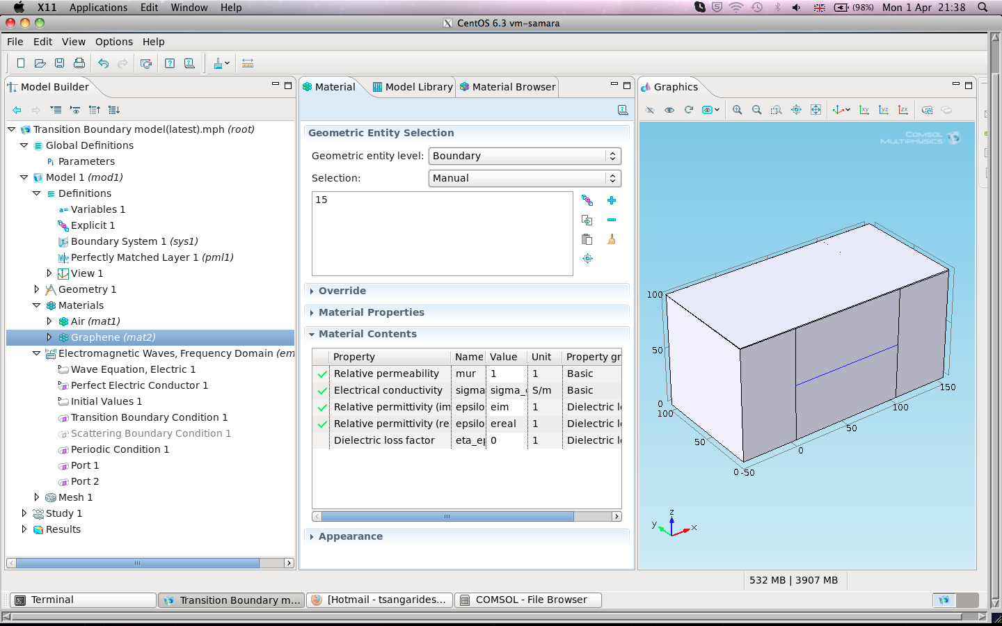

And finally in the graphene image, I typed in the conductivity and any other relevant info needed for the studying.
I am posting you some pictures because I cannot upload it for the moment until tomorrow. So, in the parameters I have written some equations in order to find out the conductivity (sigma_g) and relative permittivities (real imaginary/ ereal eim) In the Propagation wavevectors I have written the k-vector of light in order to emit it from port 1 in the x direction oscillating either in z or y and having an angle alpha to the z axis. In the Port1 image, there is a trial for how to emit this light but I have no idea what to write in the propagation constant, and also I think I have written wrong the Ex,Ey,Ez fields. And finally in the graphene image, I typed in the conductivity and any other relevant info needed for the studying.
