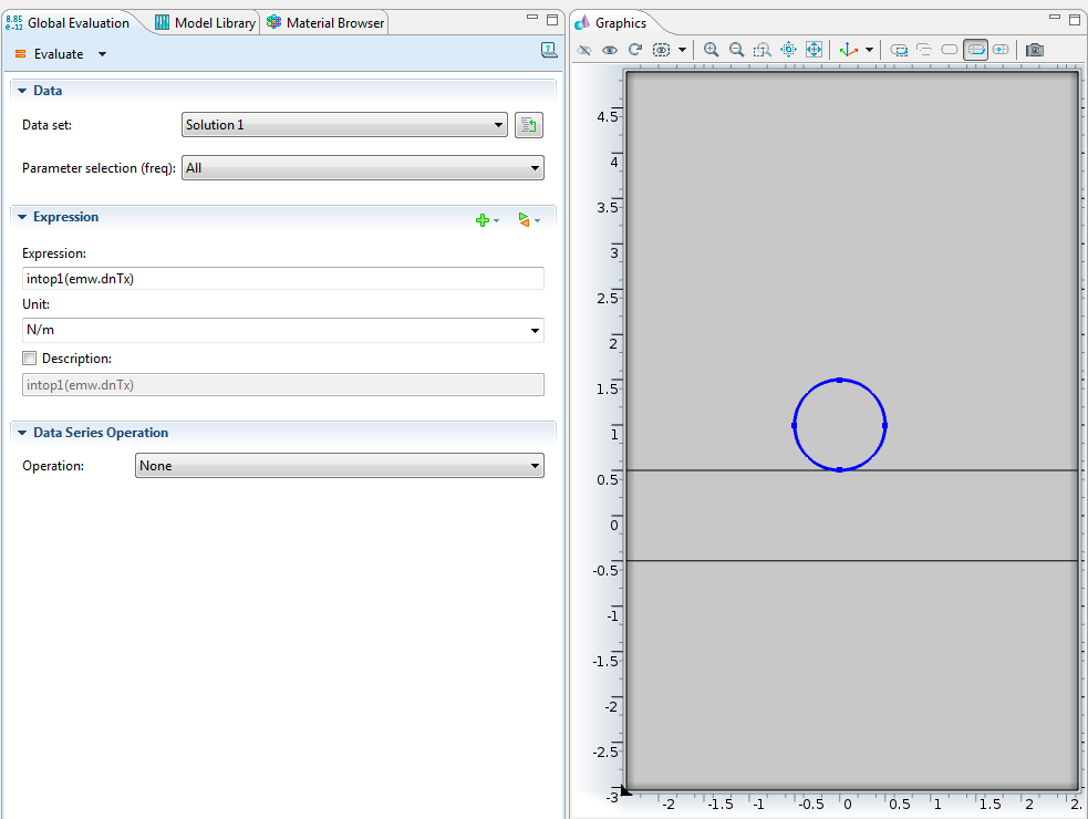

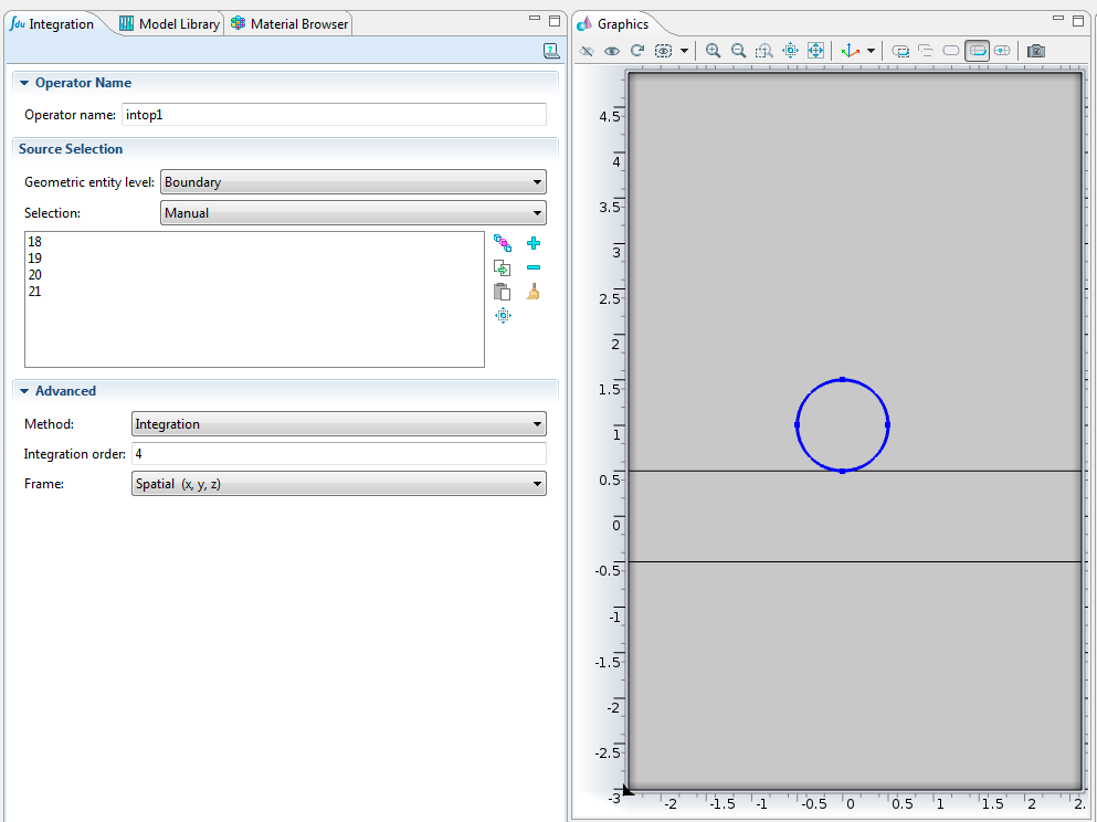

When I do this I get a force/m which is a few magnitudes smaller than what you get. I think my integration might be incorrect. If I understand correctly I want to integrate over a surface with the normal point radially outward from my sphere in 2D. A line integral will only integrate along the line. If I use a surface integral in 2D it doesn't seem to make sense to me.
I've attached pictures of my attempt but I don't know how I can get Comsol to do what I want. When I do this I get a value of 2.8*10^-10 N/m

When I do this I get a force/m which is a few magnitudes smaller than what you get. I think my integration might be incorrect. If I understand correctly I want to integrate over a surface with the normal point radially outward from my sphere in 2D. A line integral will only integrate along the line. If I use a surface integral in 2D it doesn't seem to make sense to me. I've attached pictures of my attempt but I don't know how I can get Comsol to do what I want. When I do this I get a value of 2.8*10^-10 N/m Thanks, Mark.
