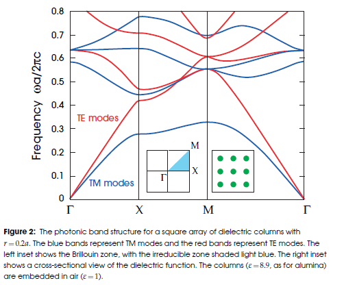

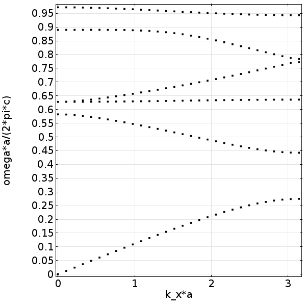

Thanks for your reply Chris,
I already figured it out with the double Floquet BC's which indeed allows me to solve for the eigenfrequencies - but only if i leave out the ports alltogether.
Anyways, i am trying to reproduce the results in the attached band diagram (using the same parameters). If i have ky = 0 and sweep kx from 0 to pi/a, this should correspond to the Gamma -> Chi segment in the diagram. As i compare my results with the reference they match pretty well, but it seems like i only get the TM solutions out. What if i want the TE solutions as well? I don't understand why the periodic BC's would restrict the polarization.
- Jens.

Ahh - i had chosen to solve for the out-of-plane component only, choosing the in-plane component obviously resulted in the TE-bands :)
Seems like everything is working then. Thanks a bunch for the inputs :)
- Jens

Hi guys,
Do we have to mention the source and detector? I got the eigenfrequencies but it doesn't match with band diagram Jens had given last post. What could be the problem? I didn't define any theta, just define kx=m*pi/a and ky=0 to get from CHI-GAMMA!!
