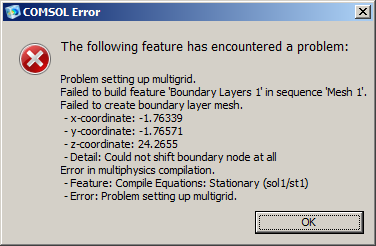

When I add a second (circular) air layer under the substrate of my sensor (Geometry 1 -> Air Layer Keramic (1/2) and (2/2)), I can still generate the mesh properly.
However, as I run the simulation (study 7-steady state) the following error appears:
Problem setting up multigrid.
Failed to build feature 'Boundary Layers 1' in sequence 'Mesh 1'.
- x-coord: -1.76
- y-coord: -1.76
- z-coord: 24.265
- Detail: Could not shif the boundary node at all

1) The error.png is a figure that shows the COMSOL error.
- x-coord: -1.76
- y-coord: -1.76
- z-coord: 24.265
