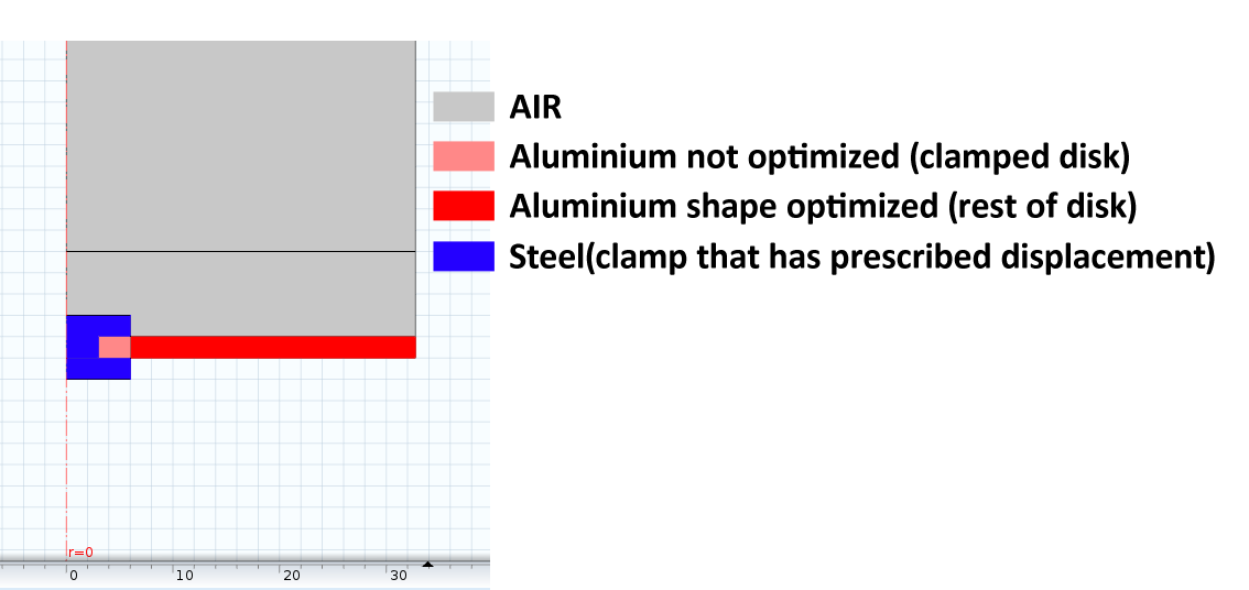

I'm currently optimizing the shape of a vibrating plate in an closed hollow cylinder filled with air to get an as straight as possible wavefront. I model it 2D axisymmetric and make use of solid mechanics and pressure acoustics in the frequency domain.
My plate is drawn as an rectangle and I only want the top line of the rectangle to be optimized, however now my whole shape (top and bottom line) of the rectangle are changed equally. Which is logic because I set a prescribed mesh displacement in z direction, but I don't know how to do it another way. I tried an parametric curve, but then the geometry and mesh aren't updated.

PS the attachment is an overview of the geometry and the materials.
