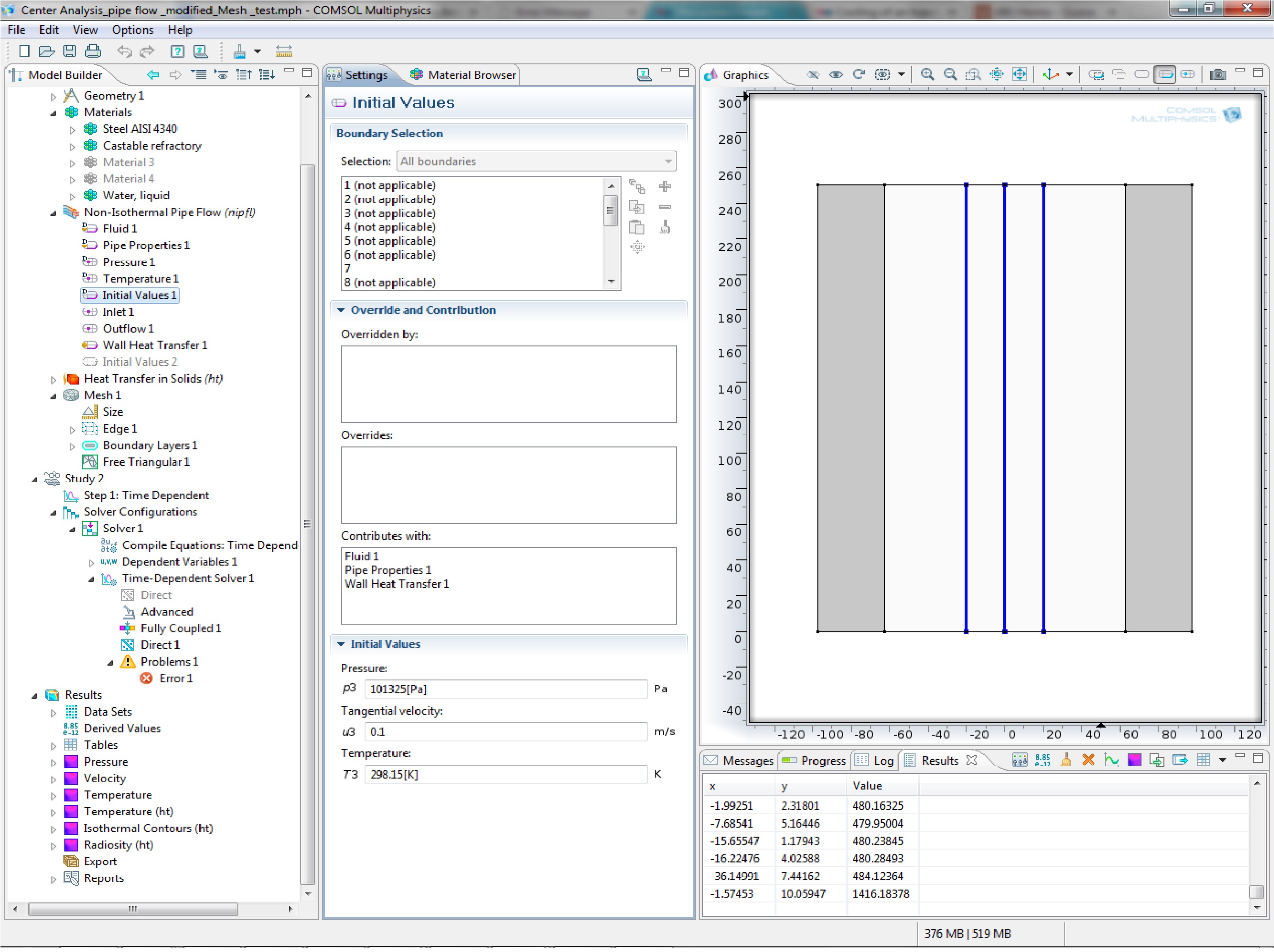

I am working over a simple pipe flow problem, where I encountered with an Jacobial Error saying ;
Failed to evaluate variable Jacobian.
- Variable: mod1.nipfl.u3
- Geometry: 1
- Boundary: 7 10 13
I request you to kindly help me.
This is a coupled HT and Isothermal pipe flow problem, where three straight pipes are used to cool the structure. I think, I am facing problem with the initial value i.e. Tangential velocity for which I don't know the sifnificance of it niether it is explained with the mold cooling module ( example model )
Please see the Jpeg Image.
PFA

Dear Ivar,
I even couldn't be able to figure it out. There is no issue with the pressure, however it is showing error with the tangential velocity (u3) of pipe.
- Geometry: 1
- Boundary: 7 10 13
I am unaware of this terminology, tangential velocity, therefore request you to out some light on it.

the most frequent issue with Jacobian errors, are related to non-continuous BC equations, be sure you give scalars, or CONTINUOUS functions for all entries in the BC settings. At best use the "smooth" step or rectangle functions under Model Definitions Functions
Hi the most frequent issue with Jacobian errors, are related to non-continuous BC equations, be sure you give scalars, or CONTINUOUS functions for all entries in the BC settings. At best use the "smooth" step or rectangle functions under Model Definitions Functions -- Good luck Ivar

Thanks, But, as asked earlier, please help me to understand the meaning of Tangential Velocity and its significance.
I only have the Flow velocity, Which I have defined in inlet.
