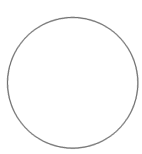

I'm not sure I fully understand what you are trying, a drawing or a model could make it easier to catch ;)
Please find attached the drawing of my model. It is just a simple ring. What I am trying is to look at the heat conduction only in radial direction by turning of tangential heat condcution. I have a coupled sturcutal mechanics module with my model. The structural part is not the problem. It is the heat equation I am trying to configure.
