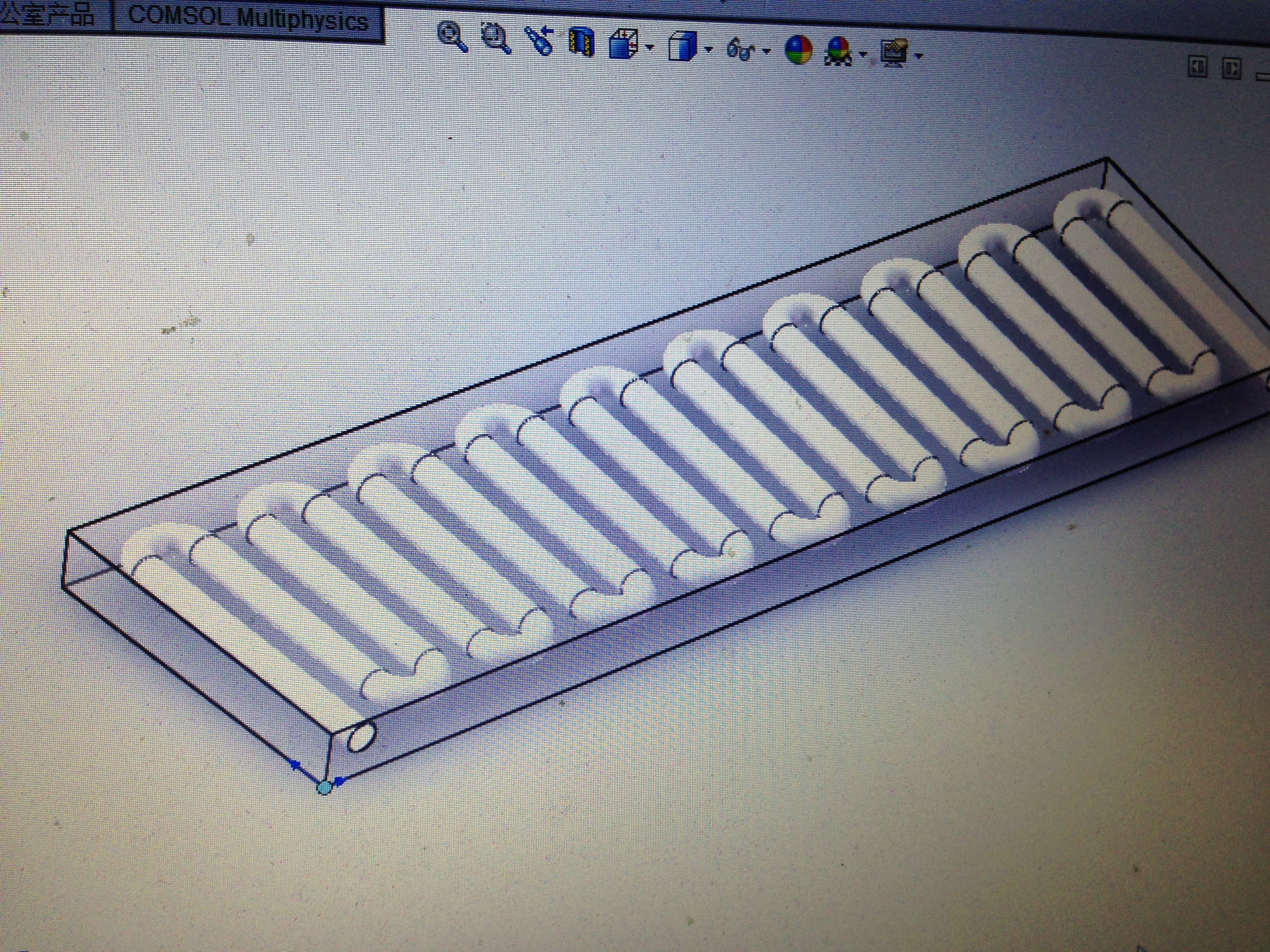

This is a concrete slab with embedded loop. I don't want to use the free tetrahedral to mesh this model since the result is not as accurate as quad element do if the order of the shape function is the same according to the finite element method. So I am writing this email to ask whether there is a reasonable solution to this model?

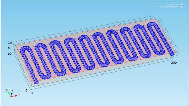

It is easy to map the embedded loop which, by the way, is hollow. See attached file. And I know I could convert the boundary of this loop to tri to mesh the rest part of this slab.
The problem is that this way has no essentially difference,apart from the advantage of control of mesh size, from the way I use Free Tetrahedral directly.
I want to use hexahedron. Do you think this is possible?

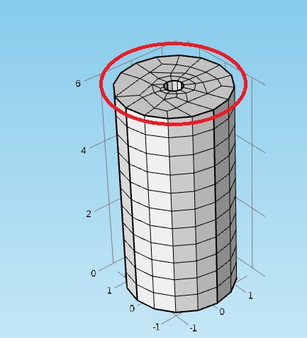

Here you have mentioned the swept meshing, How can I symmetrically mesh a concrete cylinder. I am not able to come up with symmetric meshes on the top and bottom surfaces (please see the attached picture).
Thank you,
Hamid

Hi, Here you have mentioned the swept meshing, How can I symmetrically mesh a concrete cylinder. I am not able to come up with symmetric meshes on the top and bottom surfaces (please see the attached picture). Thank you, Hamid hfakhri@buffalo.edu

If I understand what you want to achieve, this should work for you: divide the top face into two equal halves, and mesh those two halves with swept meshes (you get regular quad meshes), and then sweep that down.

Hello Hamidreza, If I understand what you want to achieve, this should work for you: divide the top face into two equal halves, and mesh those two halves with swept meshes (you get regular quad meshes), and then sweep that down. If difficulties persist, or if the above is not clear, please contact support@comsol.com . Best, Jeff
