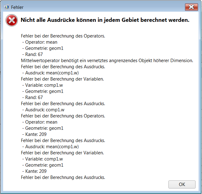

Posted: 10 months ago 11.09.2025, 16:40 GMT-4
Updated: 10 months ago 11.09.2025, 16:45 GMT-4
Hi Edgar,
let me summarize:
at:
Edge-3D & Study1:
  • at z+w(x or arc length), Error caused by w (see picture attached)
  • at z, pristine outer edge contour (crowning) is plotted --> correct values
Cut Line 3D:
  • at w, displacement of the cut line --> plausible
  • at z, pristine position of cut line --> plausible
  • at w+z, --> correct calculation
Sure, from that results it would be possible to calculate the resulting real contour, howsoever.
But why do I always get pristine values for z, for all data sets? How can I obtain deformed position values?
Thanks, Sven
Hi Edgar, let me summarize: at: Edge-3D & Study1: - at z+w(x or arc length), Error caused by w (see picture attached) - at z, pristine outer edge contour (crowning) is plotted --> correct values Cut Line 3D: - at w, displacement of the cut line --> plausible - at z, pristine position of cut line --> plausible - at w+z, --> correct calculation Sure, from that results it would be possible to calculate the resulting real contour, howsoever. But why do I always get pristine values for z, for all data sets? How can I obtain deformed position values? Thanks, Sven
