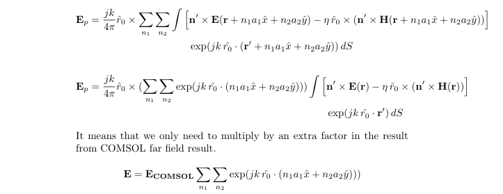

Yes! From the math structure of Stratton-Chu, I also found that a phase factor is necessary to solve it but my mates not always agree with me. Your advise is really helpful for my work. I will look at it to if there is a difference between my factor and that factor. Thank you again.

I want to know the factor af3() could be. I think it should be a complex number. But from the document, it seems a real number. Is there a source of the array factor?
>I recommend you study the example model: "microstrip_patch_antenna_periodic" in the Comsol-supplied Application Library. "Modeling of a Phased Array Antenna" >Application ID: 88011 . See https://www.comsol.com/model/modeling-of-a-phased-array-antenna-88011 . Be sure to read the discussion of how the far field computations are done in the associated .pdf file. You need to apply an array factor. I want to know the factor af3() could be. I think it should be a complex number. But from the document, it seems a real number. Is there a source of the array factor?

I get it. They are totally the same.
