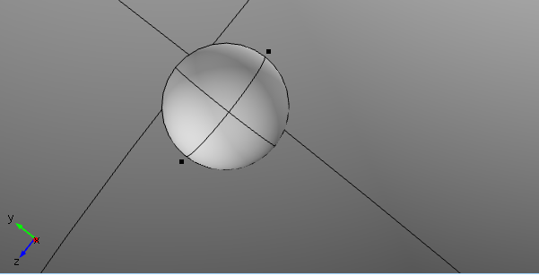

I want to add 2 electric field sources around sphere. I used 2 electric point dipole in 3D around it on the same axis(z).
1- I determine 2 physical points and then linking between them and dipoles.
2- After that I choose the dipole moment option and I get 3 data entries for x, y and z, I know that these values determine the polarization of dipole moment and according to these values the power will be perpendicular to the polarization direction.
My first question is how can I determine the polarization direction and the physical points play a role in that.
The second: how could I convert from [A.m] unit to electron volt.
The attached pic is my structure and it is radio frequency model
Thanks in advance
