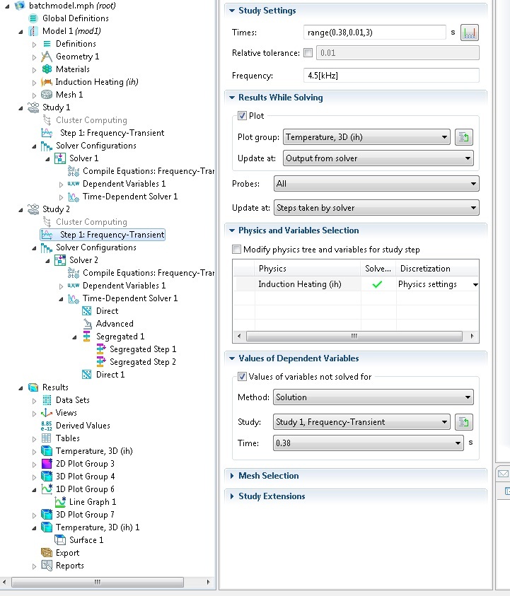

I am doing a simulation where the output of Study 1 has to be hihlighted in Study 2 as initial value for further calculation.
Problem I am facing :
1. I am not getting as Result 2 for Study 2
2. Might be the results of study 2 is highlighted with Studty 1 is Results however I am unable to post process the result for Solution 1 and Solution 2 differently, as both are giving the same results.
Please let me know how to input the VALUE OF INITIAL VARIALBLE as shown in attached fihure. ;
If I have run the simulation for study 1, say 6 seconds, and now I want to input the value of the Temperature obtained from study 1 at t= 0.38 seconds as input value to the study 2 and woule like to tun it further for 3 seconds with the same boundary conditions except the Temperature valuse if from Study 1.
Can you please see the attachment and let me know how to use this feature ? Please explain the significance of Automatic, All, Interpolated in VALUE OF INITIAL VARIALBLE, shown in figure. ?
