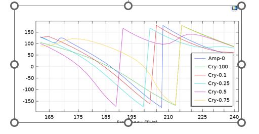

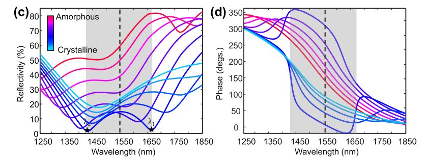

Hello everyone, I am a student working on a PCM-based metasurface for amplitude and Phase modulation in COMSOL in ewfd. I am re-simulating the Fractional crystallisation of GST's amplitude and Phase from the paper "Reconfigurable multifunctional metasurfaces employing hybrid phase-change plasmonic architecture".
I have almost obtained the amplitude modulation, but the problem is the phase modulation, which is totally opposite to it. I have used Arg function and mod function, but the result is still not the same. I would be thankful if someone has the solution for this in Comsol.
