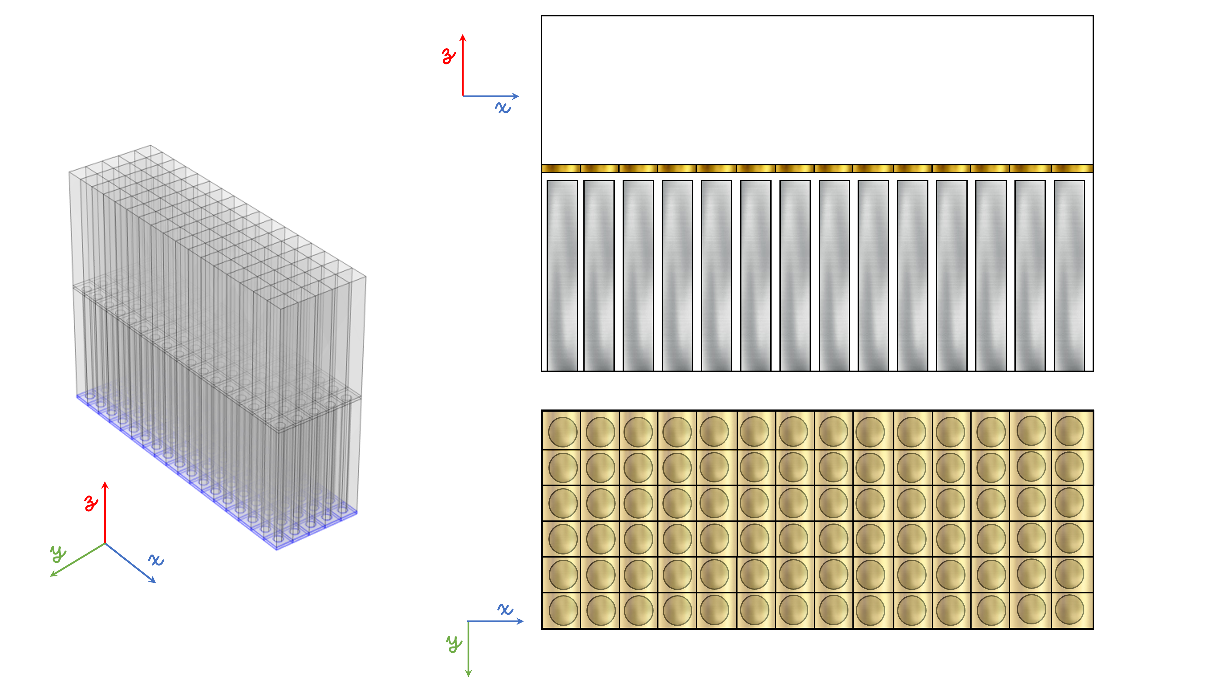

I am developing a device composed of nanowires (vertical metal cylinders) embedded in a polymer matrix, topped with metal electrodes (shown in gold in the illustration).
To facilitate calculations, I am simulating on a 2D model.

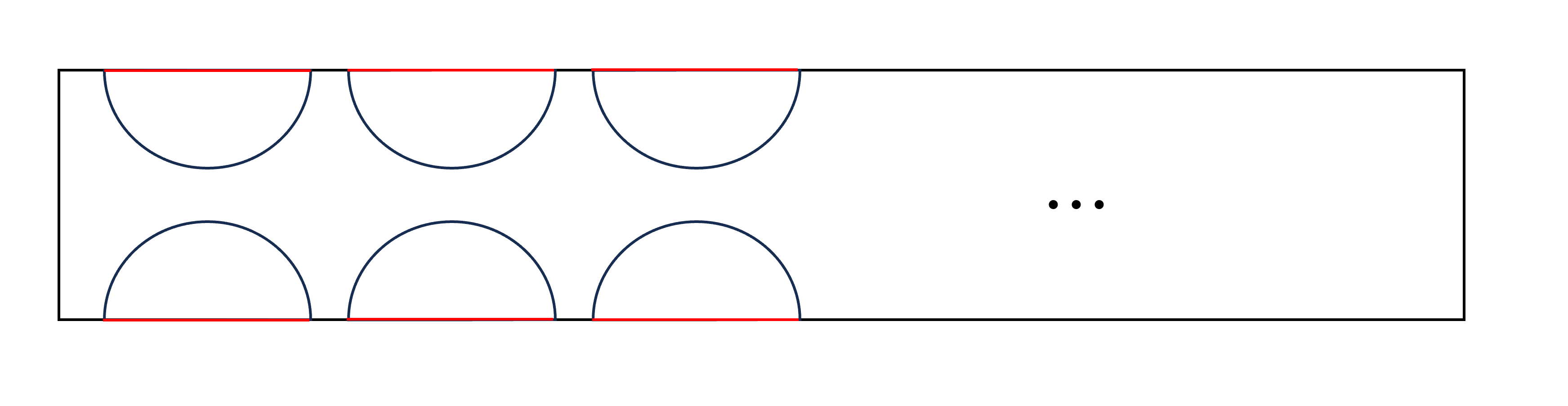

I would like to: - draw half-spheres to represent the cylinders in a top view (I will not draw the electrodes in this case) - use periodicity conditions (why not Floquet conditions?) at the half-spheres to duplicate them in one direction.
-> What periodicity conditions could I use? How are they configured?
