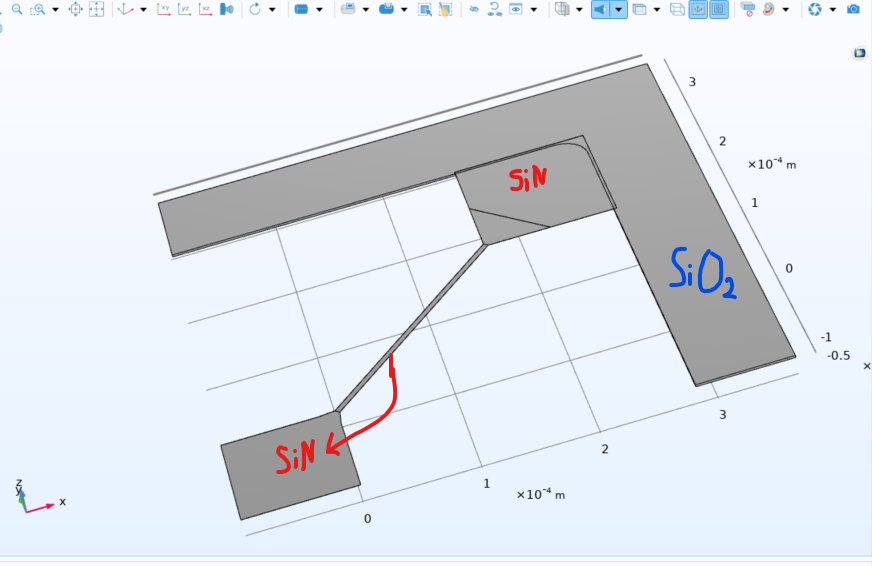

I am simulating 1/4 of a SiN membrane suspended with 4 thin arms and clamped to the surrounding substrate, the membrane is very thin (100nm) but very wide and long (high aspect ratio managed using Swept function in the mesh) and the entire structure has an isotropic damping equal to 1/Q where Q is set to 100.
Performing an eigenfrequency study, I am expecting to find for all the modes a value of Q (that COMSOL evaluates automatically) equal to the value I set (100). Unfortunately, for the fundamental mode this doesn't happen; precisely, the Q of the fundamental mode is sometimes higher (120,130,150) and sometimes smaller (70, 80) than 100. In addition, every time I launch a new simulation run (even though I do not change nothing) the value of Q (and consequently the Real and Imaginary parts of the eigenfrequency) changes.

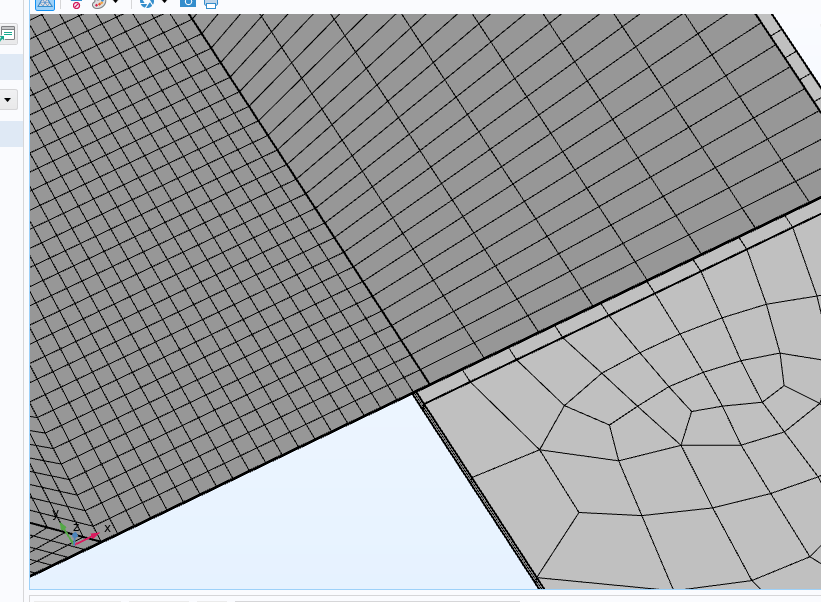

I followed your suggestions and tried a much finer mesh and I also extended the overlapping surface so that there are more than just 1 mesh domain in the overlap region (as showed in the picture). Unfortunately, this changes didn't give any improvements ( eigenfrequency of fundamental mode and Q change at each run).
Do you think that using an Union instead of an Assembly (as I am doing now) could give improvements? I am open to other suggestions. Thank you
