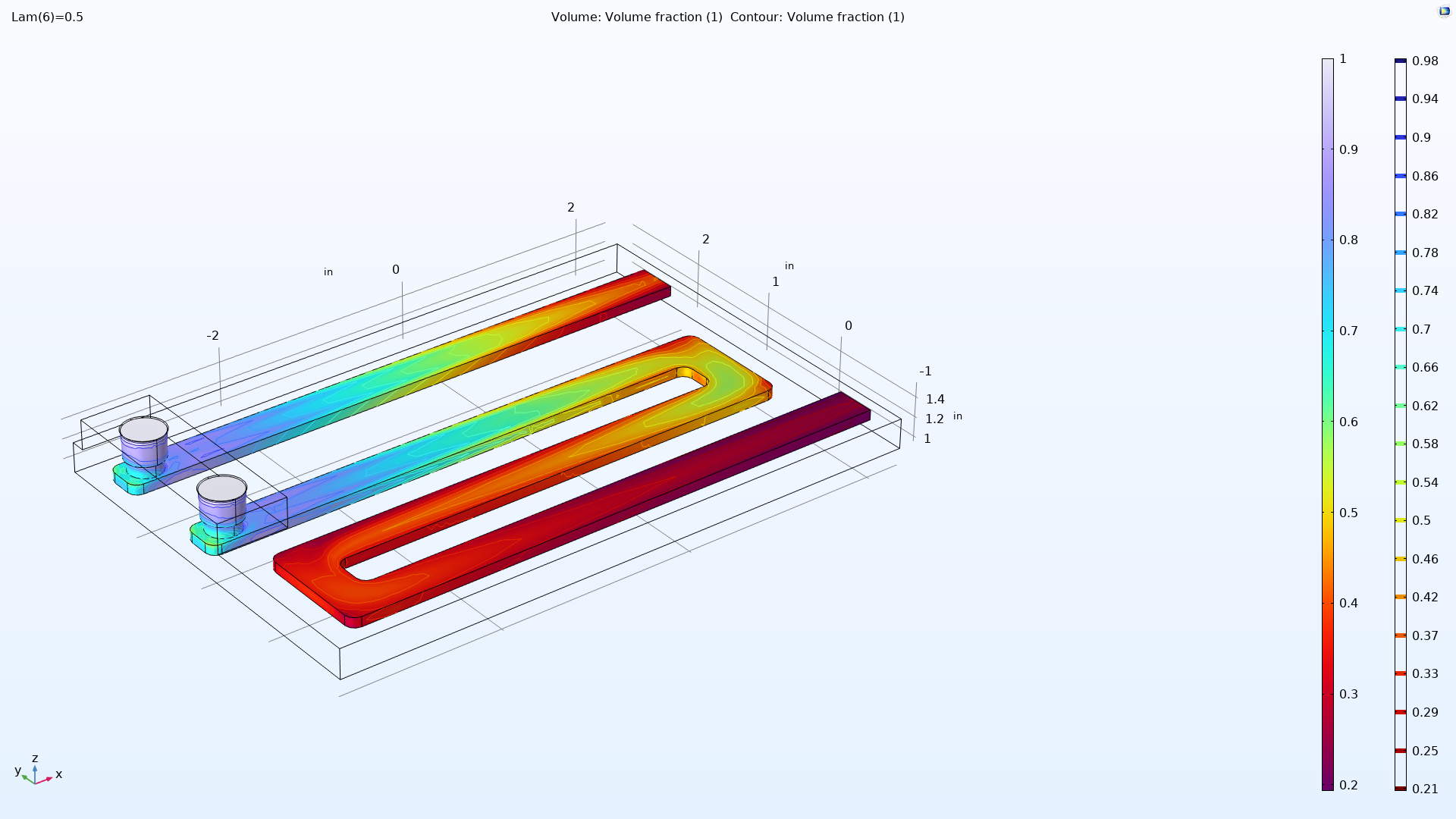

here is the application, and screenshots of my own model in an experiment that converged using water, as a reference: https://www.comsol.com/model/subcooled-nucleate-boiling-with-extended-rpi-model-113081
