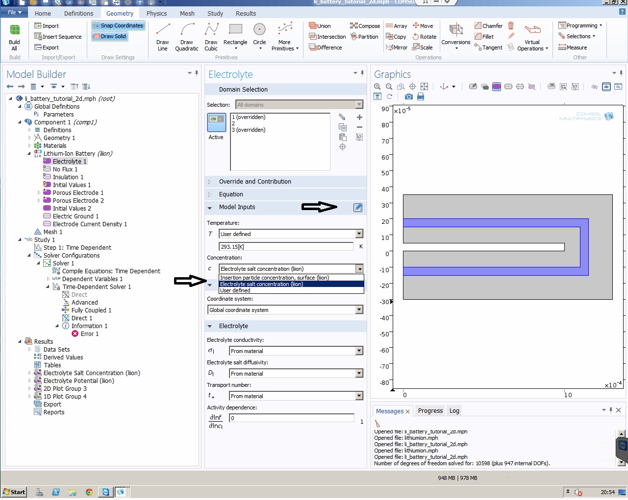

The issue comes along within the Lithium-Ion Battery Physics and the Electrolyte (Electrolyte 1). If you look closely, the concentration "c" is blocked off and permanently set to the Insertion Particle Concentration. In the tutorial, this has been changed to reflect the "Electrolyte Salt Concentration (lion)".
To make this change, you need to click the pencil icon at the top-left of the Model Inputs tab which says "Make all Model Inputs Editable." This will remove the greyed out concentration selection and allow you to change it to the Electrolyte salt.
