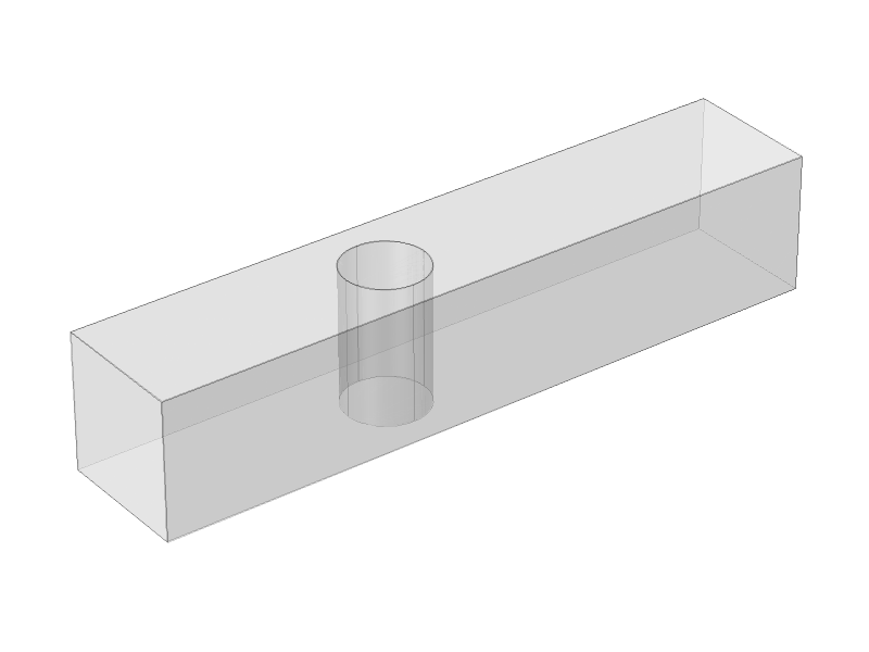

Hello everyone,
I have a beam , and the force is acting on the top surface of the beam , but only in a certain region. Hence, I should not select the entire top surface as the surface acting for the boundary load, and neither is the force an edge load. Hence, how should I select this region (say it has a certain shape) , so as to apply force to only that part of the top surface. I really do not know whether this is a trivial question or not. I am very new to comsol , and hence not familiar with this.

You can write any expression in the text field for the load. As an example
10[MPa]*(Z>0.3[m])*(Z<700[mm])*(1- Z/100[mm]).
This is a linearly varying load, being nonzero between Z=0.3 and Z=0.7
Henrik
Hi, You can write any expression in the text field for the load. As an example 10[MPa]*(Z>0.3[m])*(Z
Posted: 1 decade ago 12.06.2013, 11:00 MESZ
...or you can simply create an additional body (or face with a workplane) in your geometry (with same material).
This will produce a surface at the top of your beam.
Ralf
...or you can simply create an additional body (or face with a workplane) in your geometry (with same material). This will produce a surface at the top of your beam. Ralf
