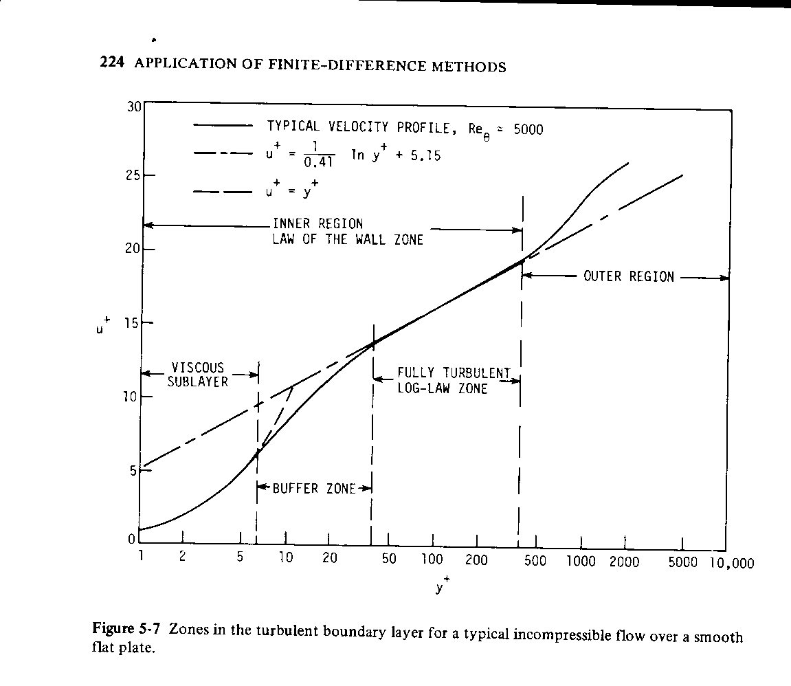

The default value for wall offset is "h/2". The COMSOL folks tell me that "h" is the length of the largest size of a finite element adjacent to the wall surface. In practice, I have found this really needs to be about the size of the normal distance of the first mesh line away from the wall. Actually, if you look at the way one is supposed to set up these problems, this first wall offset is not even supposed to be in the problem (the physical space that is). If you go look at the "flow in bended pipe" problem in the COMSOL examples, it shows this. But most folks have such thin boundary layers, that they ignore this small detail (including me).
Also Rey=10^6 is quite large. Turbulence theoretically starts at ~ 1200. So, if you really have Rey=10^6, you should have an extremely thin boundary layer and very small value for wall offset and very fine mesh near the wall. Yes the answer is questionable if you don't have 30<y+<100. This is clearly stated in the COMSOL manual. You need to have a benchmark problem in hand similar to yours to judge the accuracy. Yes, the literature is full of these problems.
I am attaching one of my favorite figures on this topic. It is on page 224 of "Computational Fluid Mechanics and Heat Transfer", McGraw-Hill, 1984, Anderson, Tannehill, Pletcher.
