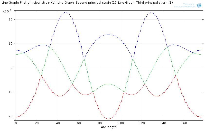

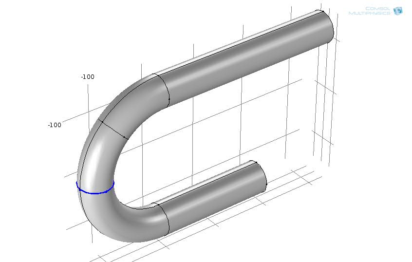

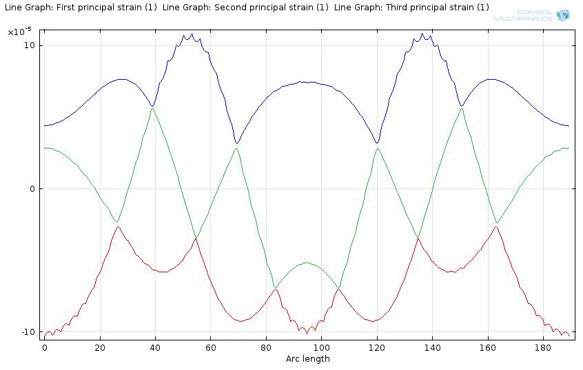

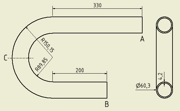

                                                    Hi Shuping,
Thank you for your reply, I have simulated by two models with different wall thickness (as shown in the table), but unfortunately it seems that, although the ratio between wall thickness and radius of the tube is already smaller than 1/20, but the inaccuracy is still ridiculously large. Will you get the same result as me?
Wall thickness[mm]..........Wall thickness/.........Max. principal strain.........Max. principal strain.........Inaccuracy
........................................radius of the tube..........by Shell [μm/m]...............by Solid [μm/m]
............4.2...............................1/6.7...............................232................................108...........................+114.8%
............2..................................1/14................................913................................482...........................+89.4%
............1,4...............................1/20................................1700...............................938...........................+81,2%
............1..................................1/28...............................3100...............................1550..........................+100%
............0.5...............................1/56...............................10400.............................5100..........................+103.9%

                                                    Hi Alick,
Regarding this problem, my understanding is that the thin-shell theory essentially assumes that the strain in the transverse direction is zero. You can check the magnitude of the transverse strain from the results of 3D solid element relative to the in-plane strain, and see if neglecting it is a reasonable assumption.  If  the transverse strain is large, then the discrepancy of the results from two approaches are due to the limitation of thin shell theory itself.  Let me know what you find.
I looked at the documents for autodesk simulation about their shell element:
wikihelp.autodesk.com/Simulation_Mechanical/enu/2014/Help/0328-User_s_G328/0572-Setting_572/0607-Analysis607/0656-Nonlinea656/0657-Element_657/0672-Planar_E672/0678-Shell_El678
I don't see too much difference, although I am not an expect in FEA nor in thin-shell theory. I think both software use a relaxed thin-shell theory that allows the rotation of local normal direction on the reference surface at original state while undergoing deformation. In other words, this type of elements should also work for relative thick shells.
An expert in solid mechanics should easily give us a clear answer. I am more of a thermofluids guy, so the above is almost all I know about shells.
