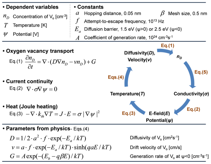

I have same problem. I am trying to solve Drift diffusion(time dependent ) and Joule heating(time independent ) equations simultaneously. One important thing in my simulation is that electrical conductivity and thermal conductivity are function of Temperature(T) and concentration (cA). I have solved the drift diffusion equation first with a constant temperature(T0) and then coupled with joule heating equation by changing T0 to T.
The coupling was done by copying the solution and then changing " initial values of variables Solved for for" in the dependent variables option of the solver 1. After solving thing I don't get any electric field or potential in solution.
Could you please advise me ? I have attached the file herewith.
Thanks,
Sanjoy
