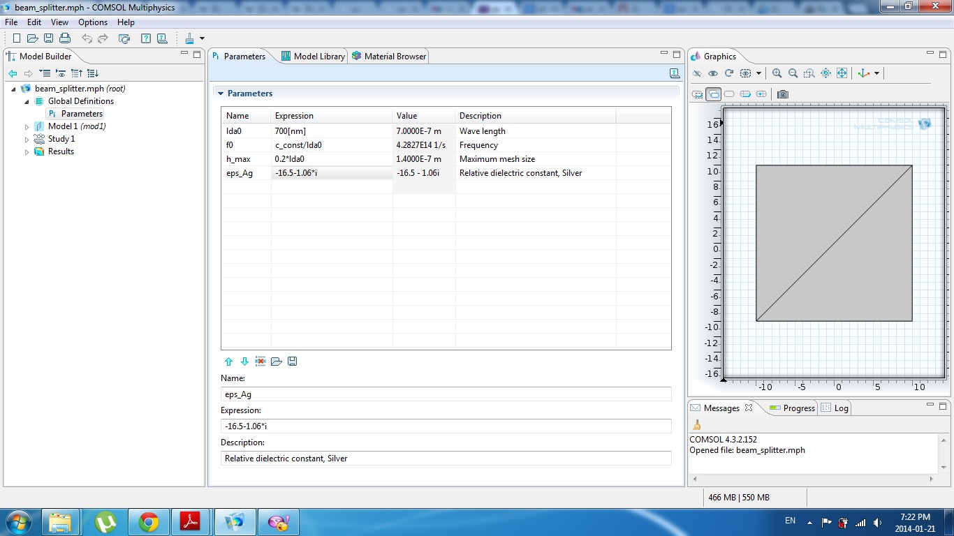

I am trying to implement a beam splitter configuration in COMSOL, but I'd like to use Gold, Aluminium or Chrome instead of Silver. The default COMSOL implementation uses Silver, with the relative dielectric constant: epsilon = -16.5-1.06*i. I need some similar values for the other three metals...
Do you have any idea for my situation? I searched all over the internet, but without any results... :( How could I determinate the relative dielectric constant (even if they are complex numbers) for Gold, Aluminium or Chrome?
Please answer!
Best regards: Ferencz Szilard, Technical University of Cluj-Napoca.
a little Google search using 'permittivity of gold at optical wavelengths' already yields many hits. Among many others this one: fisica.ufpr.br/jfreire/EstadoSolido/optical%20contstants%20of%20noble%20metals.pdf
which should already answer your questions. It also describes how to measure the complex permittivity. And keep in mind, it is very frequency dependent in the optical domain.
