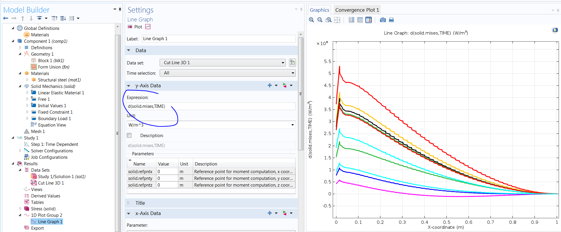

I tried to evaluate the largest value in solid mechanics, and the variable of interest is solid.mises. I used the same way as indicated in your model, but neither 'solid.misest' nor 'd(solid.mises)/dt' works. Do you have any suggestions? Mine is the 2D case.

none of you two variable names, formulas do work in COMSOL, the dependent variables (in solid u,v,w) not solid.mises has a derived value defined. You could try the derivative operator d(solid.mises,t) but check in the doc why you should rather use "TIME" the mesh time, instead of "t" solver time.

u3-nojac(if(solid.mises>u3,solid.mises,u3)) where u3 is the dependent variable in ODE. I also set the damping coefficient to 0 as indicated in the blog. But what I got was not the maximum value of solid.mises during the time-dependent study.
When I randomly chose a point to evaluate solid.mises, it showed a realistic curve (shown in attached figure). However, when I evaluated u3 for the same point, it showed a monotone increasing trend (shown in the other figure attached), which is not correct. Do you know why did this happen?

Thanks for the suggestion. Indeed, I need to use "TIME" instead of "t".
