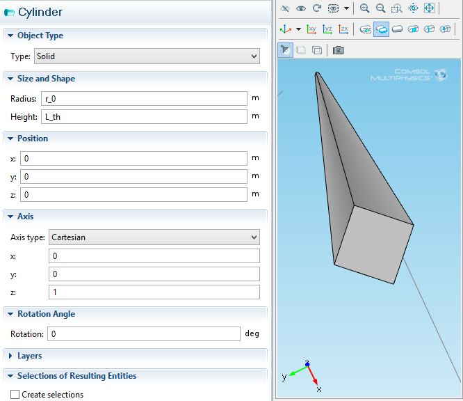

I am quite new to this program and I tried to do create a 3D circular duct.
I selected Cylinder and chose a radius of 0.004 m. In case of a short height compared to the radius, the cylinder keeps its shape in the graphics window. But when I select my desired height of 2.6 m the shape of th cylinder turns into a block! I found out that, the more the height/radius ratio is increasing, the less round the profile becomes.
Is this because COMSOL can't simulate this profile? Or is it just a bug?

I believe this is due to how Comsol Multiphysics, in coordination with OpenGL or Direct X, represents/plots 3D graphics. First of all, don't take the image on your display so literally. Remember, what actually matters is how well the mesh represents the desired geometry, not how nice the geometry's picture looks on the computer screen. Mesh your object and see if the mesh itself conforms (at least roughly) to the correct circular shape. If not, then try a finer mesh.
Another thing you can do that may help is adjust some of the graphics parameters. For example, choose Options --> Preferences --> Graphics and set Detail to Fine. This may help produce a more realistic view in the display.

You can scale your problem. Draw a low cylinder and implement a scaling factor to the height. I think I saw such an example in a tubular filter demo in the Comsol model library of an earlier version.

Look at "dialysis" in the model library. There you have the scaling example.
