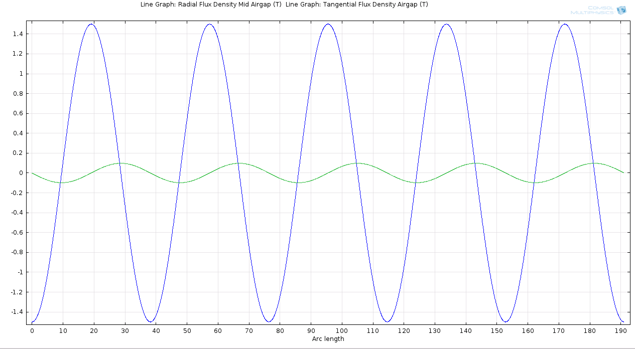

I am doing magnetic field simulations to validate analytical models. For this I need to have the line graph of the radial field in the airgap for example. This works fine, as long as I plot it over the arc length. However I would like to plot it over the angle. I defined an angle (sys2.phi) and the plot works fine, except that Comsol connects the end with the start with a straight line, which messes up my plot.
Does anybody know how to get rid of this connection?
Is there a way to plot over [0, 2Pi), which would solve the problem?
