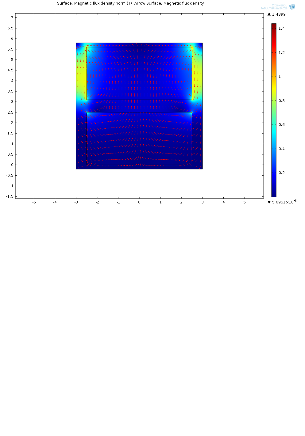

hello, i want to make a permanent magnet, and see the magnetic flux density norm using arrow surface. i found a picture of a magnet, see attached photo, but i need to know how i can make this, because i need similar magnets for another project. i've been trying different methods but so far it has been unsuccessful. please can someone help me.?

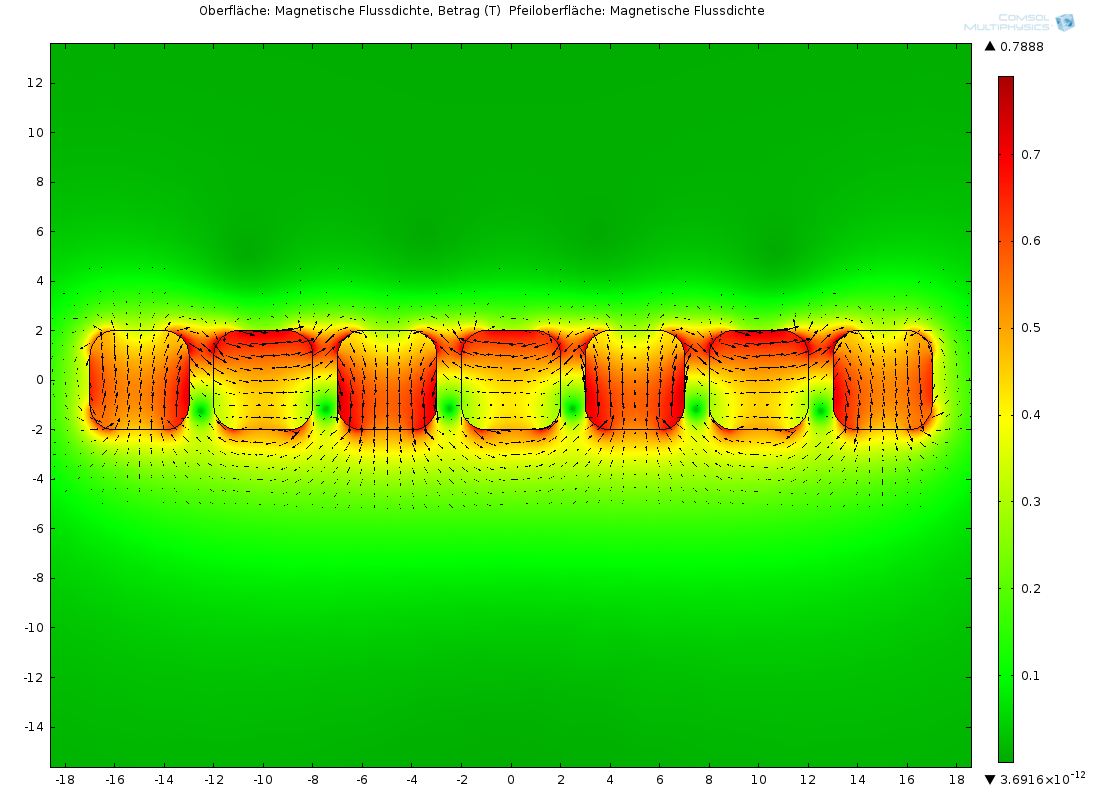

Posted: 1 decade ago 30.10.2013, 05:00 MEZ
Thanx a lot Ralf...
I have attached the image below, I assigned remenant flux in accordance to ur instructions.

Posted: 1 decade ago 30.10.2013, 07:42 MEZ
Hi!
I think the best would be to study comsol manual and some of the examples in the model gallery:
www.comsol.de/models/acdc-module
There you should find some more explanations for basics.
Ralf
