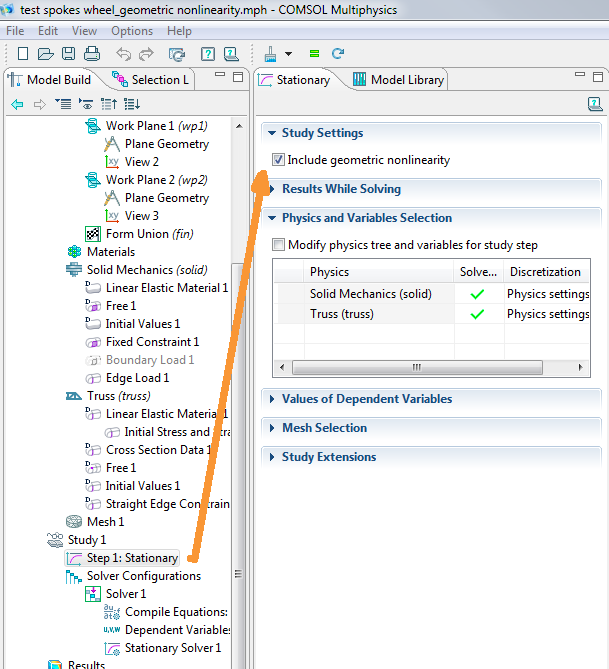

I am struggling with combining trusses and solids in a spokes wheel. The error "The relative error is greater than the relative tolerance" still remains, allthough I tried a lot of different meshes, loads and constraints.
Can anyone solve this problem?
I attached a COMSOL 4.3 file of the spokes wheel.

Dear Albert,
As trusses can only sustain axial forces, it is needed to enable the checkbox "geometric nonlinearity" in the study.
This will take the extra stress of the truss into account when there is a small rotation in the wheel. Thus resulting in the minimal stress state when there is no rotation.
Attached you can find the model.
Note that the "include geometric nonlinearity" checkbox can be found in step 1 under study 1.
Frank
Dear Albert, As trusses can only sustain axial forces, it is needed to enable the checkbox "geometric nonlinearity" in the study. This will take the extra stress of the truss into account when there is a small rotation in the wheel. Thus resulting in the minimal stress state when there is no rotation. Attached you can find the model. Note that the "include geometric nonlinearity" checkbox can be found in step 1 under study 1. Best regards, Frank

Frank,
Thanks a lot
Frank, Thanks a lot
