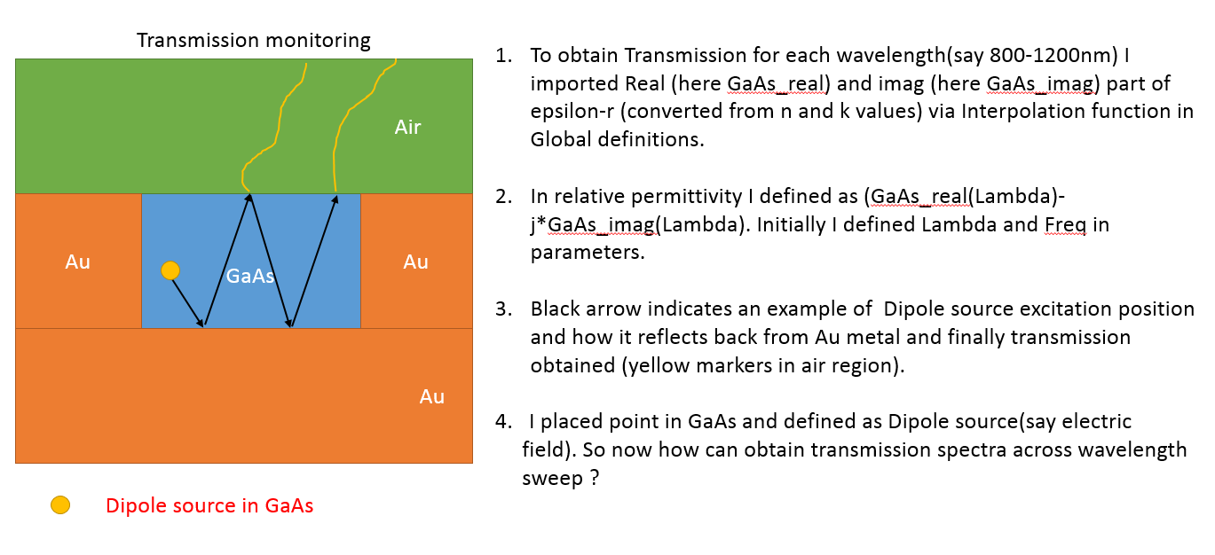

Actually Now I had imported Refractive index values via interpolation. I had converted n and k values to Relative permitivity say GaAs_real and GaAs_imag.
Previously in Parameters I had defined Lambda = 1000 and frequency = c_const/Lambda[nm]. I had used nm in Lambda since imported (ex. GaAs_real) wavelength values as say 800 ..... without nm.
In GaAs Material properties I had defined Relative permittivity as = GaAs_real(Lambda)-j*GaAs_imag(Lambda). I think this is correct definition.
So In Parametric sweep now I can do Lambda dependent.
(I had attached the concept of my simulation as picture where you can understand my idea)
My Goal is to get PL spectra (may be Transmission ) vs wavelength. I had placed Point in GaAs and used that as Dipole source. My target is to achieve Transmission spectra coming out from GaAs vs wavelength (say 800-1200nm). I m really confused here how-to-do. For obtaining transmission spectra do I need to use port condition or what ?
Certainly, you could put a boundary probe on the top air boundary to record the transmitted field, but there are several questions to determine. It is far enough away from the GaAs/Au structure to form a uniform field appropriate for retrieval? How do you determine the baseline "incident" power from a point dipole inside a small structure (i.e. in the near field)?
I've set up a short example that is probably not very accurate, but at least demonstrates the challenges of trying to do what you have requested. I set up a boundary probe on both the air and the GaAs/Air interfaces, as well as a point domain probe placed near the dipole. The results of the normalized and averaged power transmittances are shown in the global 1D plots, and show the discrepancies between using the GaAs/air boundary and the point probe.

First of all thanks for your model and try. Its really helpful since I m just beginner in COMSOL. I had attached the geometry of my structure . Previously i used Scattering BC, but now changed to PML as per your ex.
For obtaining transmission(hereafter T or PL) spectra, i think we can adjust the height of transmission monitor to get the best from GaAs top surface.
Coming to your 2nd point - //How do you determine the baseline "incident" power from a point dipole inside a small structure (i.e. in the near field)?// I couldn't understand this ? Why we have to determine the baseline incident power ?
I understood that you used Boundary probes for obtaining T. In Relative permittivity it should be square of refractive index right ?
And in Dipole, you had chosen Dipole moment . How about choosing Magnitude and direction and is it possible for getting T??
