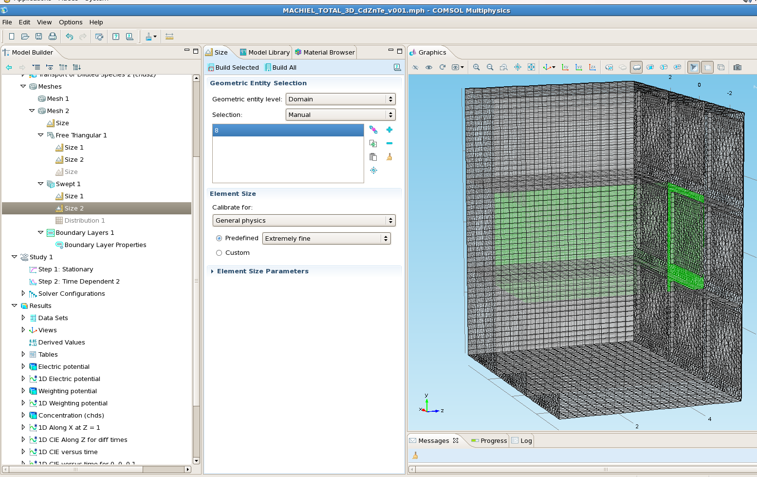

I have a problem with the mesh I am using, and I wonder if someone could help me out here. I'll try explaing it using the attached files, I apologize for the length of this post.
The file "Screenshot_20131122.png" shows the general structure of my "Mesh 2".
It also shows my geometry, which consists of an array of 3 x 3 blocks and - on the back of each block - electrodes with a size in x-y slightly smaller than the x-y areas of the blocks.

Hence, both for "Free Triangular 1" as for "Swept 1", I have two Sizes: "Size 1" ("Extra fine") and "Size 2" ("Extremely fine").
There is also a general "Size" node just below "Mesh 2", which I have set to "Extremely Fine", though I am not sure what it serves for... Does this general size node overwrite some of the other sizes set in the sub-nodes? (It seems like that actually).

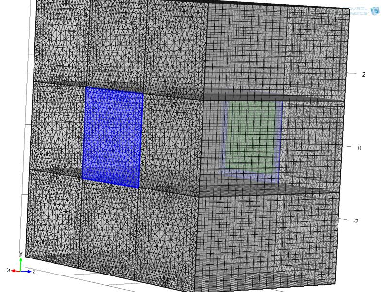

In "Free Triangular->Size 1", I select the front and back surfaces of all blocks except the center block. Hence, these are 24 surfaces in total, (8 in front and 16 in the back: both the back surfaces of the blocks and the front surfaces of the electrodes).
In "Free Triangular->Size 2", I select the surfaces for the center block. Hence, these are 3 surfaces: the front surface, the block back surface, and the electrode front surface (see CenterPixel_Surfaces.jpg).
In the Free Triangular general node, I select only the back surfaces of all the blocks (i.e. 18 surfaces in total).
For "Swept 1->Size 1", I select all neighbouring blocks (i.e. 8 in total).
For "Swept 1->Size 2", I select the center block (which has label number "8").
Fine. This all works. (I.e, I can build the mesh and then run the simulation on the mesh).
