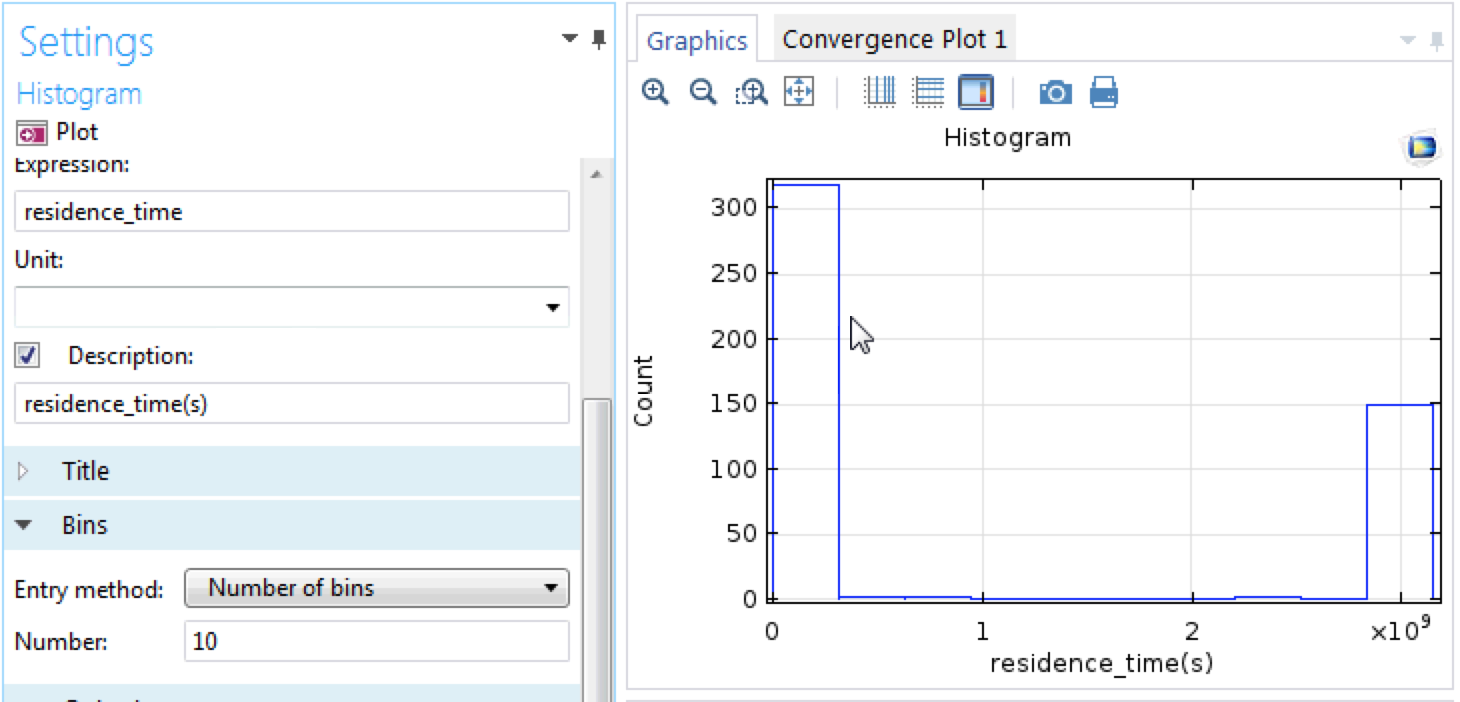

Karl,
You can use Histogram plot to visualize residence time distribution, as shown in the attached image.
Sergei
Karl, You can use Histogram plot to visualize residence time distribution, as shown in the attached image. Regards, Sergei

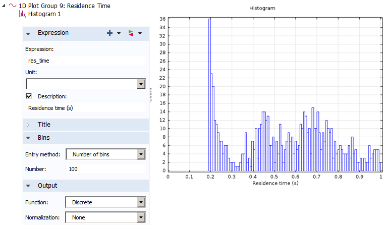

Posted: 10 years ago 08.10.2015, 11:48 GMT-4
Karl,
Sergei
If I have histogram plot for the residence time distribution, then what does it mean?
[QUOTE] Karl, You can use Histogram plot to visualize residence time distribution, as shown in the attached image. Regards, Sergei [/QUOTE] Hi, If I have histogram plot for the residence time distribution, then what does it mean?
