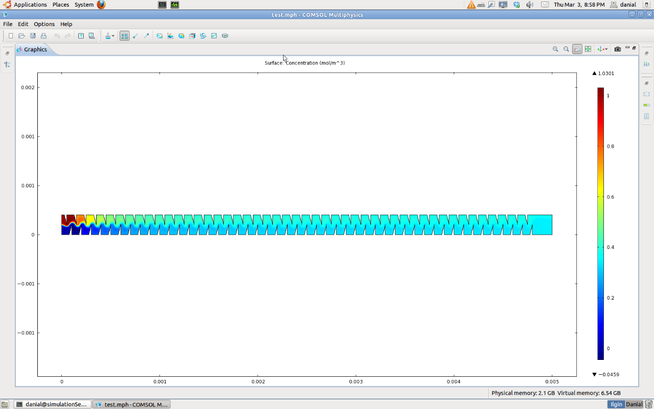

I redid your model in Comsol 4.1, since I am more comfortable with that.
- Your inlet concentration is based on hight, y, which if you look starts from -1e-4 to 1e-4, so you have actually a negative inlet concentration which messes up everything.
This is the model result I got. Of course there are some oscilaltions int he result (higher concentration than 1), but with mesh refining you can avoid it as much as possible.
Comsol 4.1
Ubuntu 10.04.1

Hi Kevin,
ok, as I said I used Comsol 4.1 and the results changed for me depending on y. If your profile is ok, then no problem.
as for the mesh, I used normal mesh.
Artificial diffusion is a *very* tricky business in finite element and C-D. Specially, for this kind of cases, where you are interested in mixing behavior.
One method you can try is this. Always use sequential solver, then try adaptive mesh refinement, go to very high mesh densities, then disable artificial diffusion. There you can see the effect of AD. Yet, since you are using Finite element, you must be sure that your mesh is fine enough to avoid oscillations in the result (the result solved without AD may not be the most accurate one).
Danial
