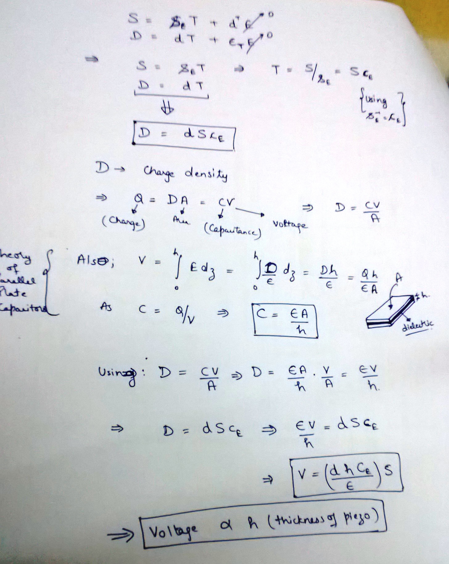

I am trying to see the variation of voltage generated by a free piezo with varying thickness of piezo, under given strain.

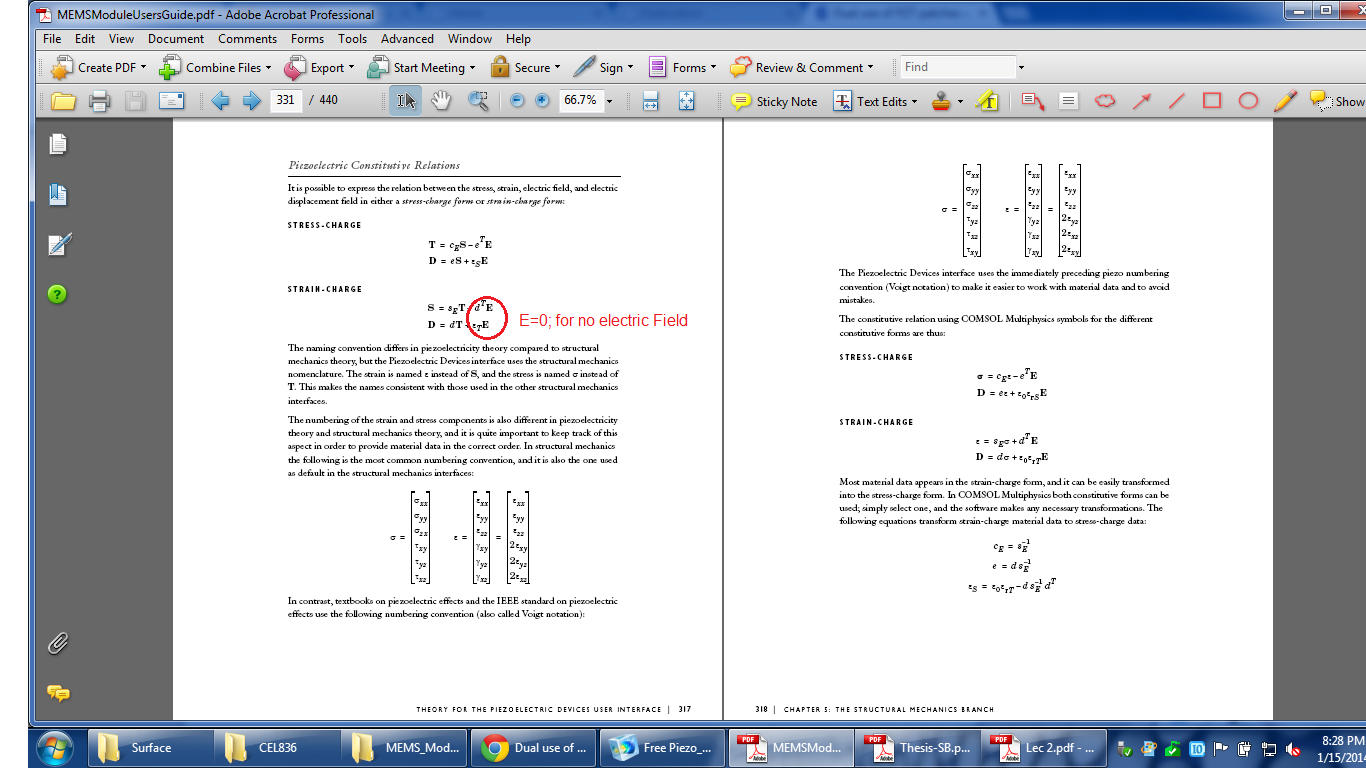

I expect the variation to be linearly proportional, I am attaching the equations (Voltage_Vs_Thickness.png file, available at C:\Program Files\COMSOL\COMSOL43b\doc\pdf\MEMS_Module\MEMSModuleUsersGuide) used by COMSOl and supporting calculations (calculations.jpg file) required further.
I modelled the free PZT and swept the thickness of piezo (study 3) but unfortunately the behavior is coming otherwise.
Please clarify.
