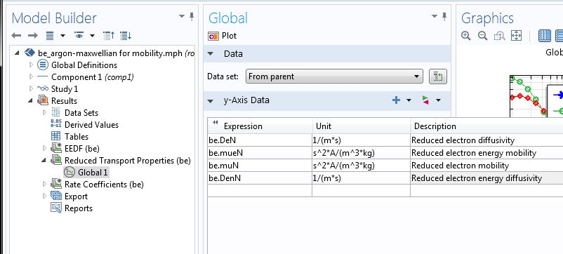

Posted: 1 decade ago 15.09.2014, 11:04 MESZ
Dear Mr. Gritter
Thanks for that..
my PC was not healthy, that is why it could not import the data..
(registry clean and so on helped)
I hope I do not have to change anything for the mobilties/diffusivities? it is not clear where to look for that?
the exports are documented (see file)
I believe these are also the import units..
arigatou..
may you have a look in my model (model exchange) and tell me why it is possible for a mwp model to have DC-plasma densities above 10E17 [1/m^3] (study1 of MVP16-upload using 250V instead of the 200V set in the variables)
