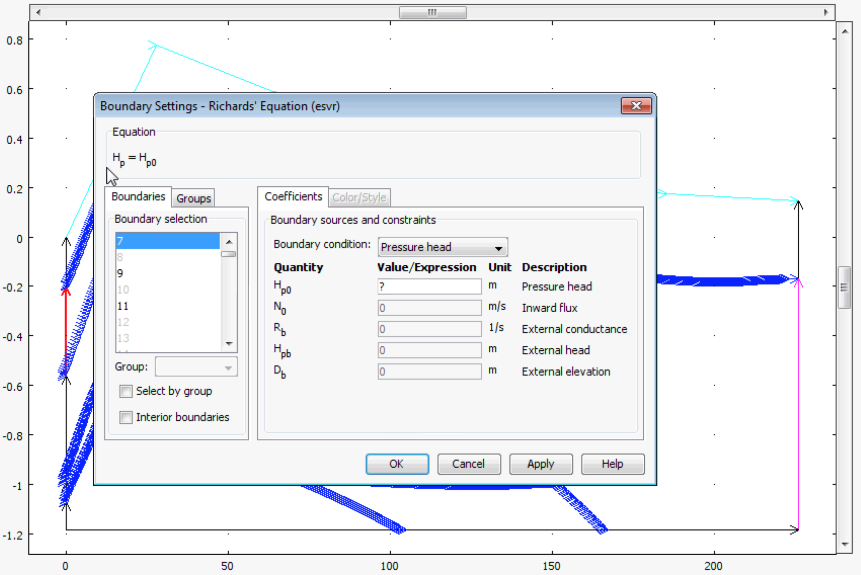

                                                    Hi all,
I want to define two conditions for one part of rectangular that I have in 2D (xz) and put two different value of pressure head in one boundary condition,
like Hp=0 if z>= - 0.5159m
and Hp=0.05159 if z< - 0.5159m
how is it possible to write these in one boundary condition?
Attached screen shot for better explanation
