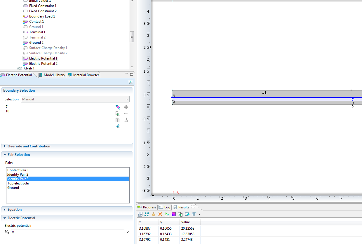

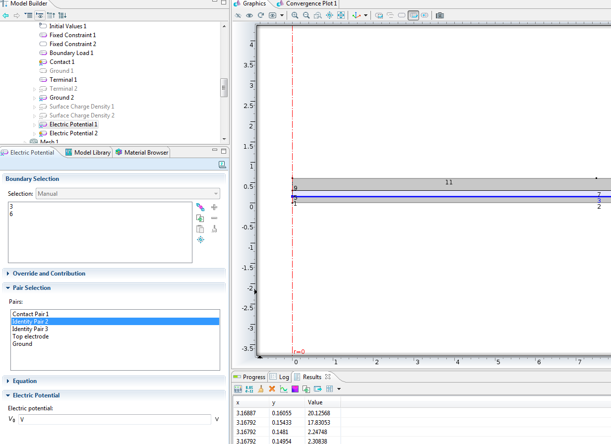

                                                    I found that by adding the Identity pair with "Electric Potential" in the Electromechanics->Pairs->Electrical, the solver could work well. But I just defined the value of electric potential as "V".  But the top plate was not deflected so much, although the applied voltage is far above the pull-in voltage.
Any suggestion is appreciated!

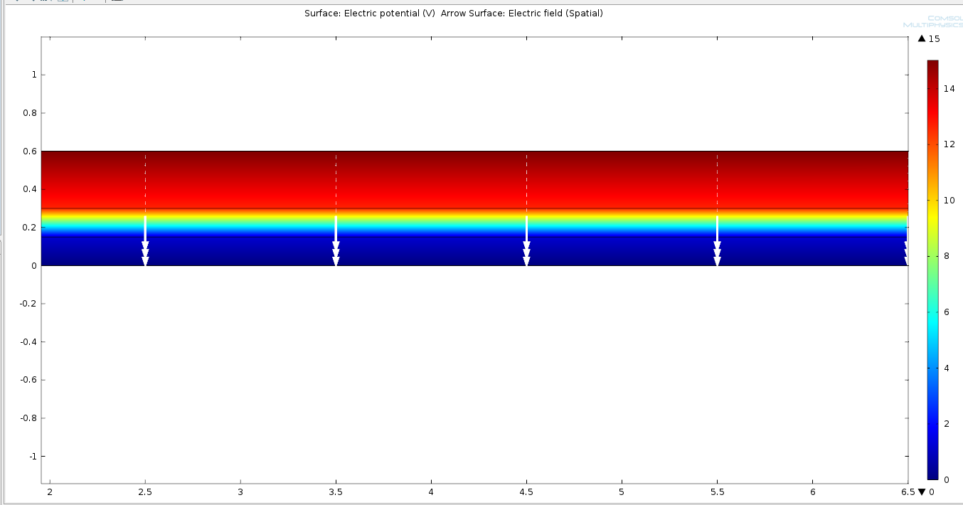

                                                    The electric potentials over the indentity pair are plotted. To my surprise, even though this pair is defined as electric potential pair in BC with the same value of 'V', the values are out of phase!!!
And I also attached a 2D surface plot of potential and a arrow plot of electric field. It seems that there is no problem for the  overall polarity of potential.

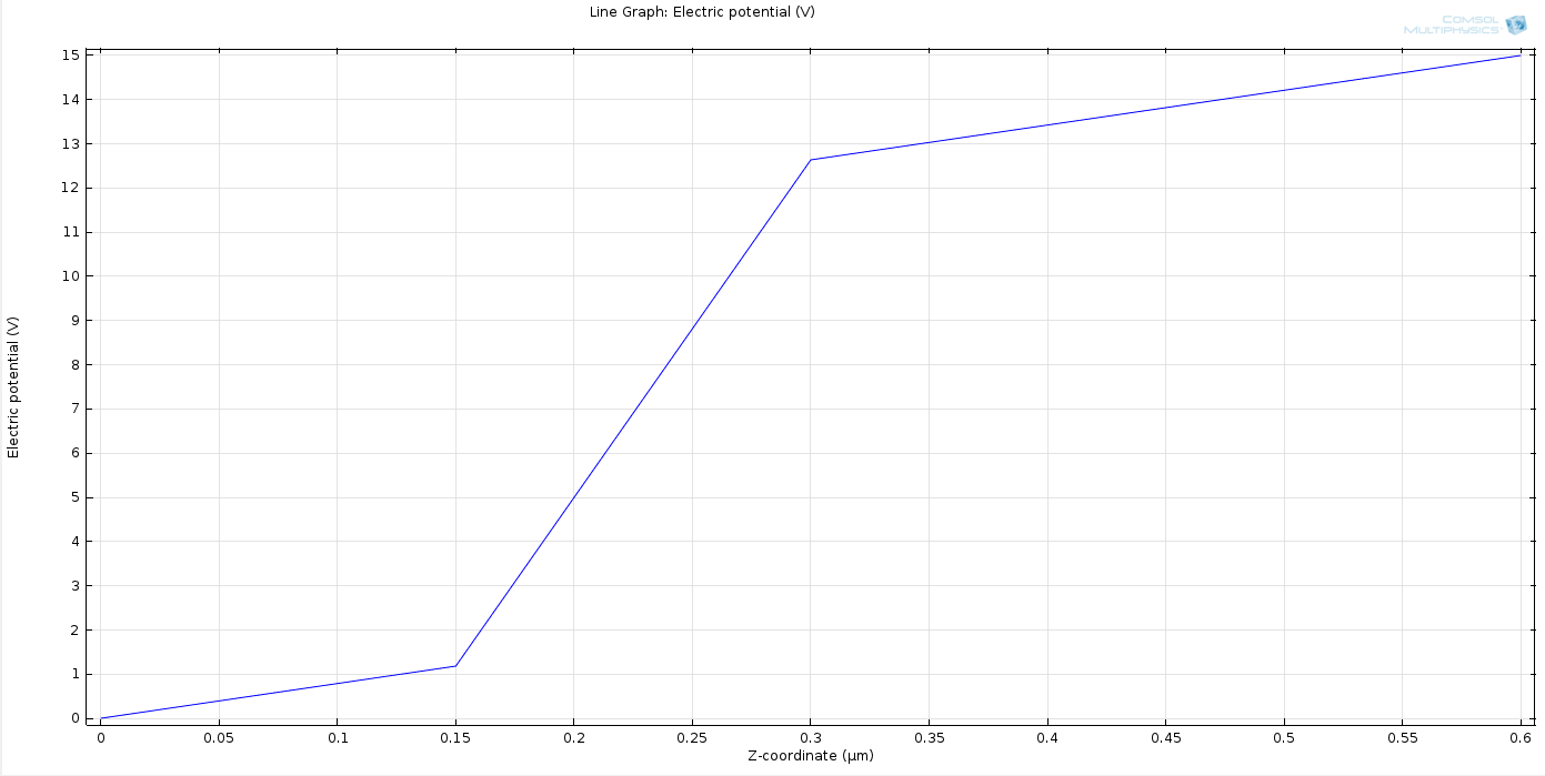

                                                    And the electric potential along the axial is attached. The plot shows that there is no invert polarity in the range.

                                                    Hi Yu, it’s hard to follow the problem without a model. If you post a model maybe someone from the Forum can take a look. Regarding the out-of-phase electric potential graphs you posted, they are not out-of-phase. The x-axis on the graph is arc-length and one seems to be measured relative to the right end and the other relative to the left end. Replacing arc-length with the axial (X?) coordinate should fix it.

Thank your for your assistance! I have modified the  x-axis, as a result, the potentials are in phase as  you said.

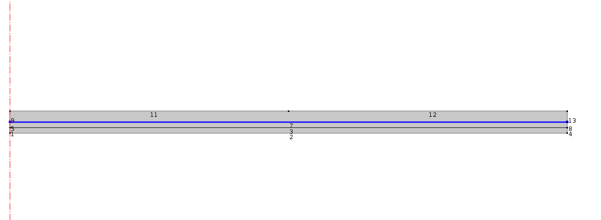

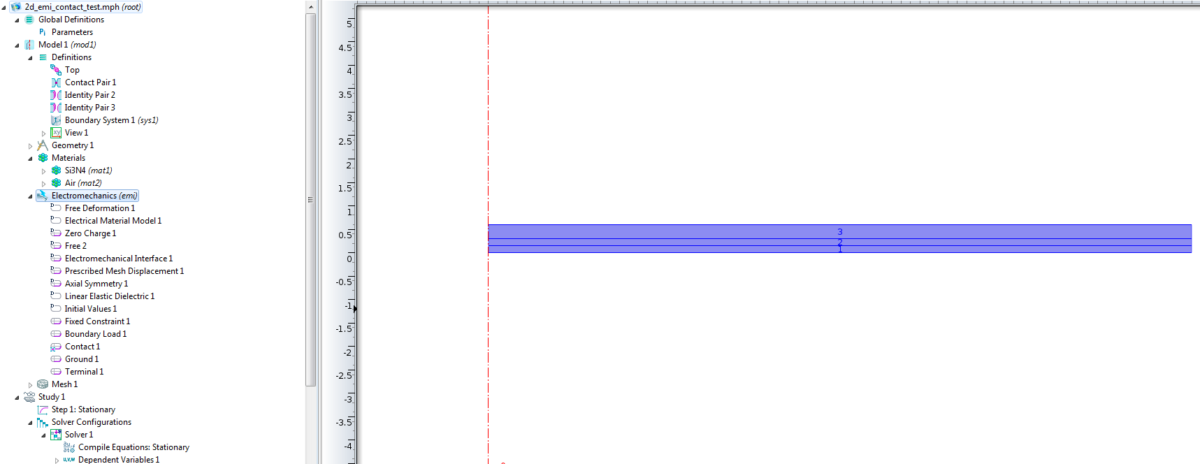

I also tried a simplifed model in es physis, the result is same. There is no electrostatic force value in the assembly geometry mode. If the geometry is changed into union mode, the force value is available.
These two models are attached for your reference. Thanks  again!
