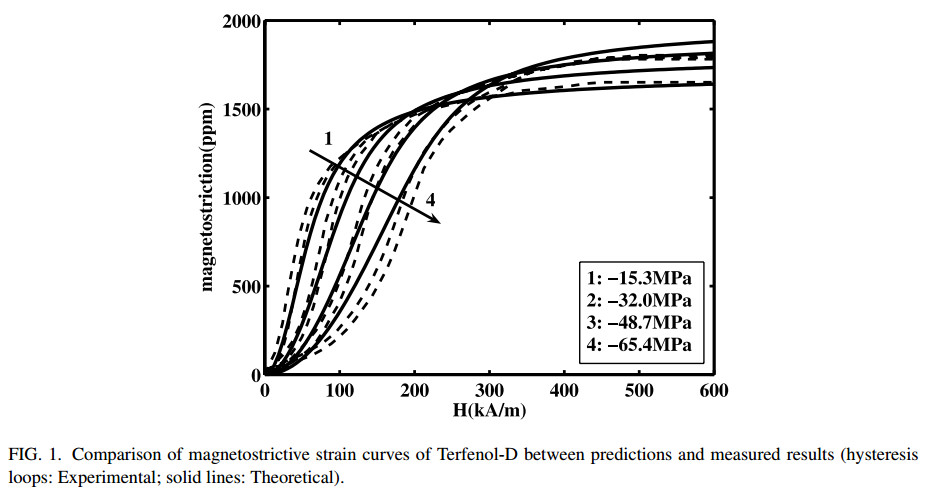

Hello, I'm also study magnetostrictive material, I want to study the nonlinear coupling stress constitutive, can you add my QQ contact 383156448 or email : sxycyzhj@sina.cn
thank you
[QUOTE] Dear all, I have a sphere of Terfenol-D in air as you know Terfenol-D is a magnetostrictive material, so when you apply a magnetic field its changes its shape. I want to model this thing in COMSOL that i want to apply a certain magnetic field and see how the shape of the sphere is deformed and by how much ? Does any one has any idea that how can i do that. I have attached a picture of the my model the middle sphere is Terfenol-D and the torus around is silica. Regards Syeda, [/QUOTE] Hello, I'm also study magnetostrictive material, I want to study the nonlinear coupling stress constitutive, can you add my QQ contact 383156448 or email : sxycyzhj@sina.cn thank you
