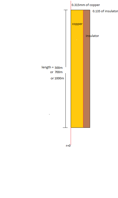

Dear all,
I need to create long and thin wire with different length of (500,700,1000)m, and radius of (0.315mm) and layer of insulator of (0.135 mm) in (2D) axi-symmetrical. But when I add the insulator layer and trying to mesh it using mapped mesh I got error of ‘’Can’t create mapped mesh for this geometry’’ .
but when I mesh it without the insulator it will be fine and no problem , except for longer wire more that 700 m.
Is there are any way to mesh the geometry with two layer? And can I create wires with length of 1000 m and radius of 0.315 mm?
I attache a simple geometry using painter.
Best Regards,
Hazlee

Hazlee,
such large aspect ratio in a model is always a problem. You should consider whether you real have to do it like that. What is the objective of this model?

Dear Edgar ,
In my study i need to check the temperature characteristic and distribution for real communication wire, that has minimum length of 500 m until 5 km length.
Is that possible in comsol ? i used 2D axis symmetric because in 3 D has more limitation.

Hazlee,
I assume that there is not much variation of that temperature distribution along the wire to be expected. If this is true then it is a typical case for a 2D planar study. What you model then is the cross section of wire and insulation and the length of the wire is taken to be infinite. The cross section can then easily be meshed with high enough resolution.

Dear Edgar,
you are right that the distribution of temperature along the wire don't have big variation. and i can study in 2D study . but i need to check the transient time that it needed to reach the steady state and this i find it using 2D. so for every length of the wire it has different transient time and this what i need to check it also.
I don't think that the transient time to steady state depends on the length in your case. We are talking about a ratio of 0.3 mm / >500 m! As soon as you are, say 1 m away from the ends, the wire extension in either direction is close to infinite. If you are interested in the ends of the wire you can set up a short 2D axisymetric model and find out how long it has to be (in a parameter study) to make the lenght impact disappear. I am sure it is less than 10 or 20 cm.

Dear Edgar,
for different length of the wire mostly there will be different temperature - time characteristic , because when the length increases the losses and voltage drop will increase that will heat the wire.
i did my model until 500 m in 2D axissymetric , but when i add layer of the insulation i got an error in meshing.
