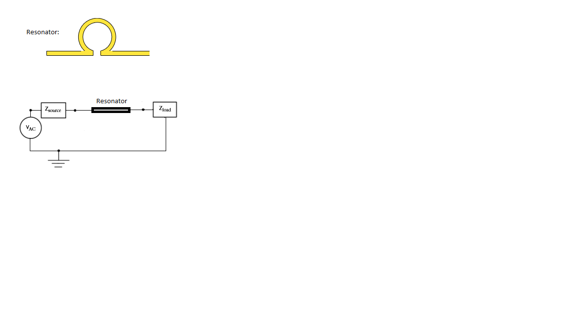

Posted: 1 decade ago 08.04.2014, 13:40 MESZ
Thanks for your fast response!
If i just remove the outer conductor, I think there will be impedance matching troubles.
There are devices called coaxial to microstrip connector, but since there isnt something like that in comsol, I will try using an AC voltage as drawn in the PNG.
Is there a way to connect my resonator to the external circuit? There is no real 'port', the resonator is a thin layer of copper forming an omega.
Best regards
Alex
