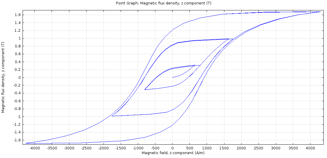

Hi Rook,
I just loaded "hysterese_example.mph" into versions 4.3.2.189 and 4.4.0.195 and it
works for me right away. See picture. I'am running Comsol on Linux.
Your PDE is simply f=0, right? Maybe you could try the "dode" interface.
Jens
Hi Rook, I just loaded "hysterese_example.mph" into versions 4.3.2.189 and 4.4.0.195 and it works for me right away. See picture. I'am running Comsol on Linux. Your PDE is simply f=0, right? Maybe you could try the "dode" interface. Regards, Jens

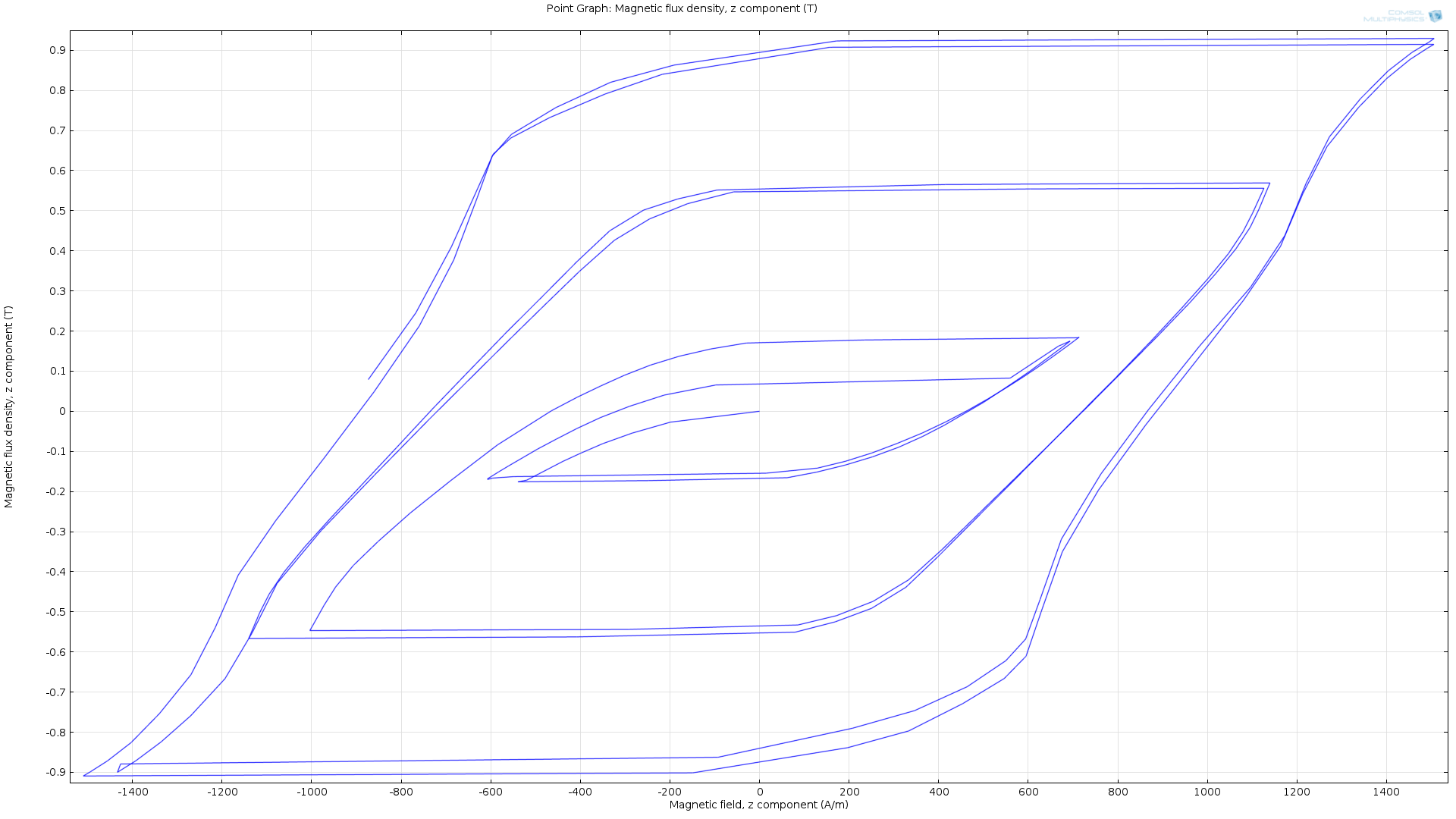

Hi Jens,
Thank you so much for your help!
It's still not perfect, but It basically works now :)
I attached the Hysteresis Curve I produced :)
Regards
Rook
Hi Jens, Thank you so much for your help! It's still not perfect, but It basically works now :) I attached the Hysteresis Curve I produced :) Regards Rook
