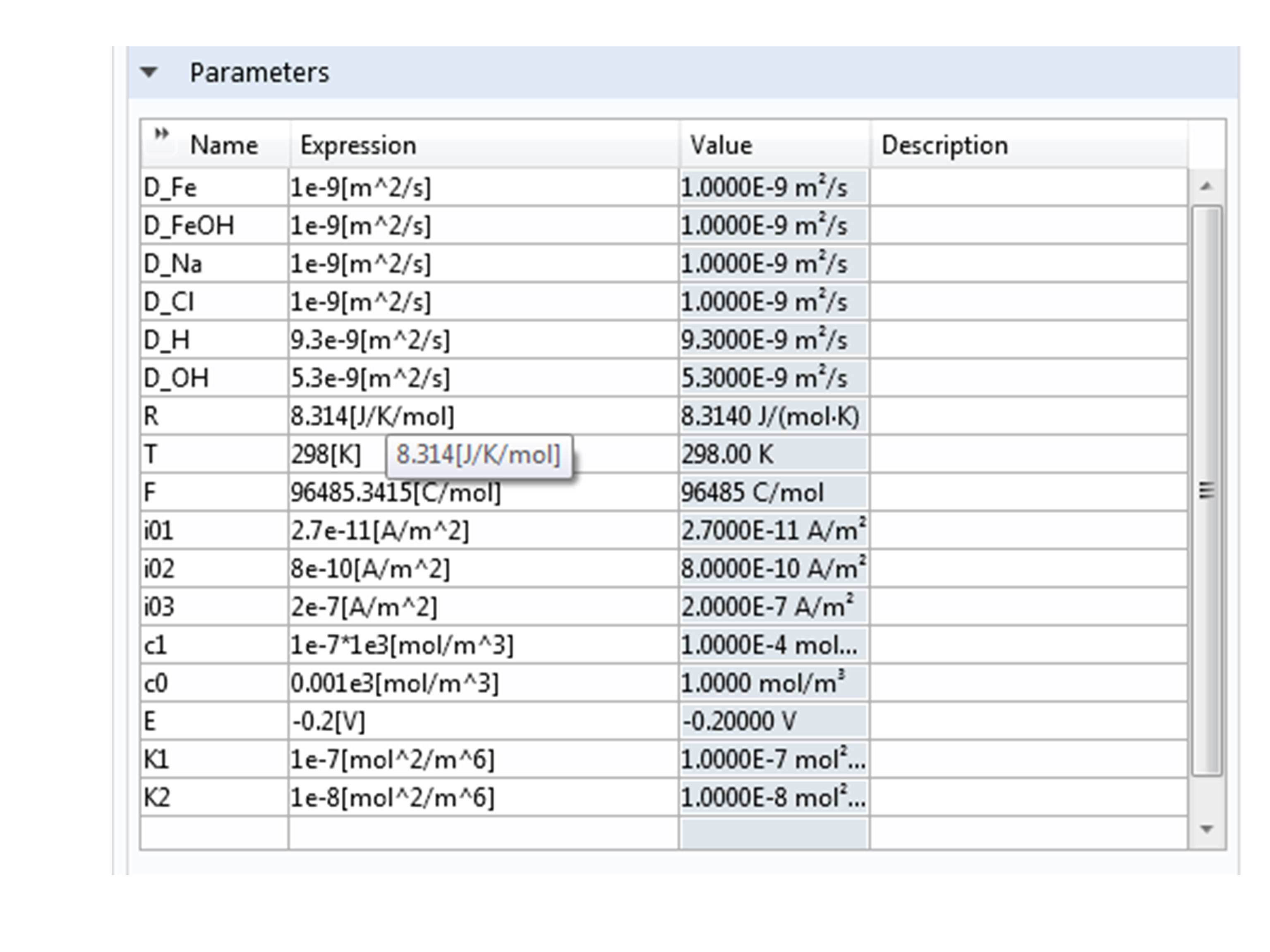

Your definition of the conductivity, k, had a small error. In the conductivity the charge numbers are raised to the second power, hence there are no negative terms in the summation.

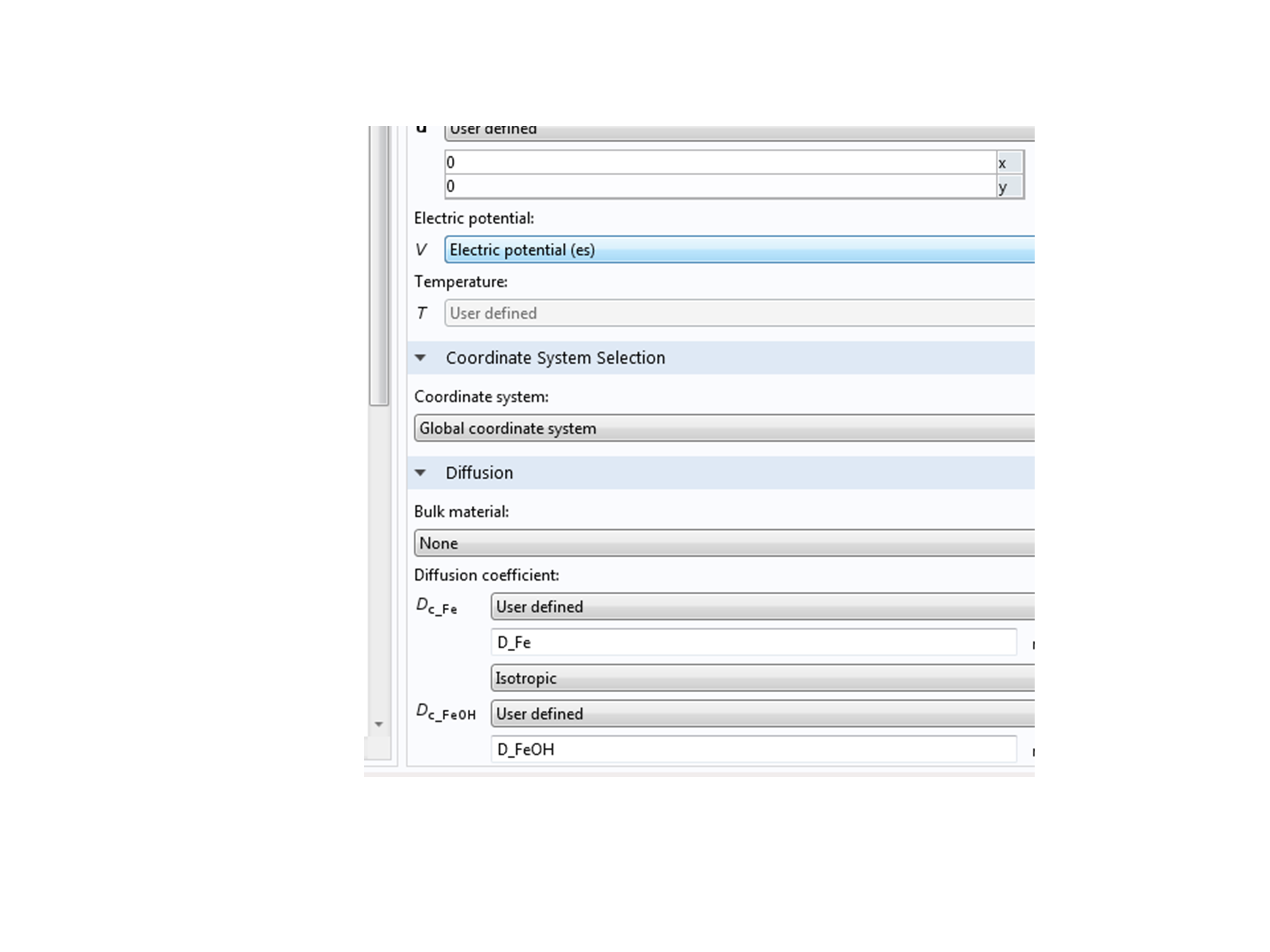

In the node Transport of Diluted Species you have to couple the voltage variable V from the electrostatics node, see figure.

I have attached my model with units too. I will play with the value of io1 as you suggested.I have also attached a paper that I am trying to reproduce.
