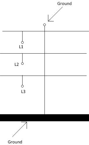

I want to study electromagnetic couplings of Transmission Lines on a tower in
quasi-static domain (50 Hz).
I use the 2D dimension and as physics I use Magnetic and Electric Fields (mef).
The solver is in the frequency domain.
My sources should be:
L1=I*sin(wt)
L2= I*sin(wt+240°)
L2= I*sin(wt+120°)
But my sources are currently
L1=I
L2= I
L3= I
My problem is I do not know if I can model something like this in frequency domain.
And I cannot find a boundary for the grounding.
I have a picture and my model attached and hope someone can help me.

Dejan,
you can apply phase shift using complex notation. Ground or electric potential BC is available under the Magnetic Insulation node.
Cheers

Posted: 1 decade ago 17.04.2014, 13:36 MESZ
The parameter J3 is a constant per your definition. You have to use a field parameter, e.g. a point plot of a magnetic flux density component or a current density component. Keep in mind that only vector components are phase dependent, the normalized quantities are not (in COMSOL). You can add points into your geometry or use probe plots.
