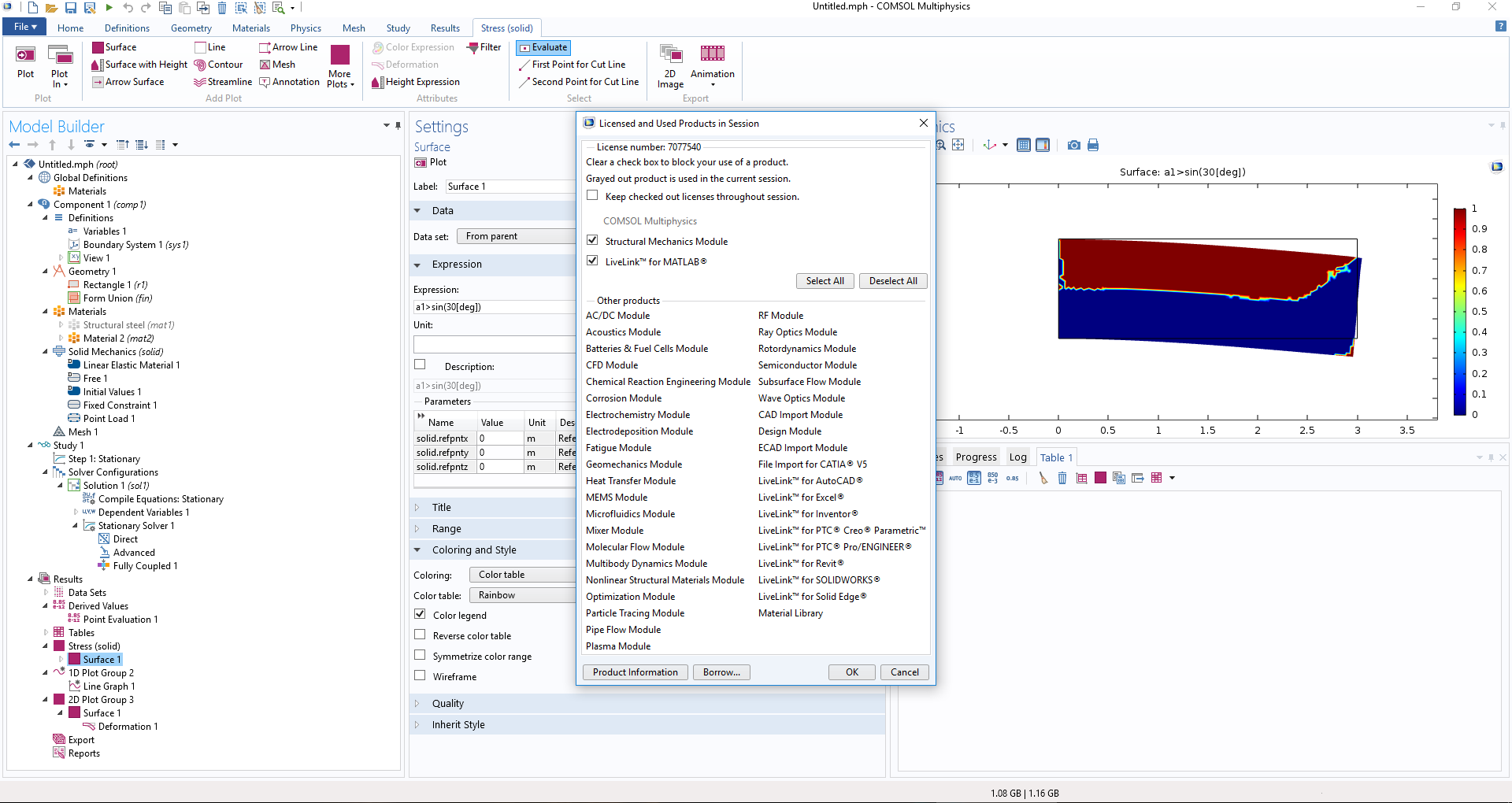

Thanks for your message.
I believe I "have" the module, please see the photo attached.
You are right. What I forgot is that for the Plasticity node to appear you need not only the Structural Mechanics Module but also either one of the Geomechanics Module or Nonlinear Structural Materials Module (See www.comsol.com/products/specifications/structural-mechanics/).
Sorry for the confusion.
